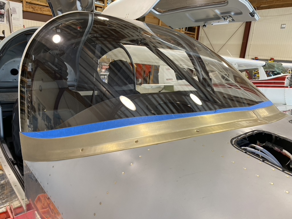

I’d like to make a removable windshield fairing that doesn’t have to be cut off like the plans call for. Has anyone accomplished this? If so Hire did you attach the fairing? Thanks

Aluminum two piece fairing attached with screws into nutplates. Still a little finessing to do to get the fit better and I will probably make gaskets top and bottom on the fairing to prevent water intrusion.
Did you procure this from the vendor before they discontinued or did you roll your own?
We did our own. I know a very skilled sheet metal “artist” and we worked on this together. Given that every windshield installation is a little different, I don’t know how a pre-made fairing would fit properly.
I’m pretty happy overall with the outcome. Since we used Sika on all the windows and won’t fiberglass over any of them - removal should be less destructive if it’s ever necessary.

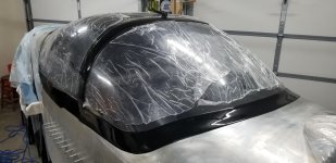

If you look around you can find several examples of removable fairings made of carbon and or fiberglass. They look nice. Wish the kits came with them.

Unlikely. Every windshield is cut slightly different so trim is also different. It's not difficult. Just a layup. If you want carbon fiber, use black tint in the epoxy for all but the last layer. Use a layer of carbon fiber for the last layer.
Bond it with Sika. Removing is just like an auto windshield.
Plus you can layup so the canopy trim slips under nice and tight.
Saw this on a rocket.
