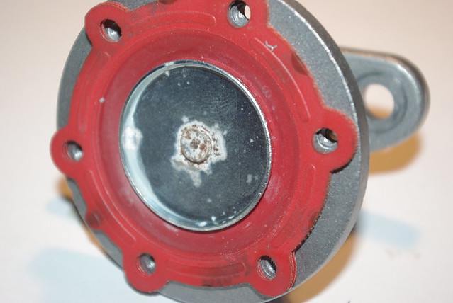

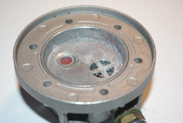

After contacting Kodiak they advised it is best to replace the fuel hoses and fuel pump (under warranty). See pictures below of debris in float bowl and some weird stuff inside the fuel pump. Still not sure where the red debris originated, and Kodiak didnt want to speculate.
The teflon hoses seem like a great option, but I probably wait a little while and will make a living with the standard hoses, hoping they wont cause anymore grief.
That corrosion is water damage and the red specs because of their size, shape and color look like part of the diaphragm. I have seen that type of water damage twice before. I think the old pumps did a better job of handling moisture.

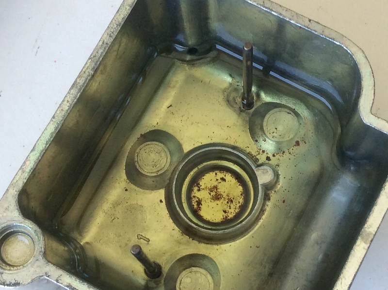

I recently completed the 25 hour inspection on the engine and found this debris in both carb bowls:
It appears to be identical to the debris reported by the OP. Looks like I will be finding out how good Rotax support is in Australia, assuming these particles are coming from either the fuel pump diaphragm (main suspect?), the hoses, or both. The fuel pump is the later version, and the pressure side fuel hose on the fuel pump was replaced by an A&P before I received the engine from Vans. Gascolator was clean as a whistle. Apart from the OP, has anybody else come across this problem?
This should NOT be RTV sealant from the firesleeve. Cant get RTV into the hose by sealing the firesleeve---unless someone tried to seal it BEFORE clamping it to the banjo. Highly doubtful. Like Roger said in an earlier post, may be from the diaphragm. Black residue---thats another story, and quite possible to be liner debris.

First the corrosion in the fuel pump.
The newer Corona fuel pumps are made of a different material and MFG'd differently than the older AC and Pierberg pumps. If water gets into the Corona pump it can cause that whitish looking corrosion and if left in for prolonged periods moisture can cause some mild pitting. We have already seen this. If this is just some minor whitish coloring it won't hurt anything. This can also happen to the carb bowls because of the aluminum metal. Water can collect in the bottom and cause the white powder and pitting. One thing ethanol laced fuels do is keep moisture trapped in solution and just burns it through the engine. 100LL and straight auto fuel don't do this and moisture can pool.

The Corona pumps were never made to take apart and reassemble. I wouldn't worry about them unless you have a constant discharge from the drain. These pumps can and do weep sometimes. So if you see a few drops (not a constant discharge) from the drain that can be normal. Some are dry all the time and some are not.

The red particles in the carb bowl can from from a few different sources.
If using fire sleeve with "End Dip" on the fire sleeve ends then this would account for the red particles because it was applied before the hose was pushed over the fitting. If you used a red silicone maybe someone either applied it before pushing the hose on the fitting or after that person applied the silicone remove the hose, even for a moment, to correct something and then pushed it back on. It may not even be a red silicone and possibly a thread sealer from somewhere else in the system.
On a new engine or an engine that has major work done on it or a hose change it is possible to see a few particles now and then. If it is a one time deal and tiny I usually don't worry and just dump them and allow a little fuel to flush out the carb with the pump with the bowl off and into a rag. If I keep seeing debris and or it is large in nature (enough to plug the main jet) then I would look much more closely. Debris from fuel tanks can be common on new aircraft and that's why we should have fine meshed fuel filters inline. Even then there can be very fine debris that can make it to a carb bowl from anywhere in the fuel system after the first few hours on a new engine. Carb bowls are a good place to inspect at the 25 hr. warranty inspection and only takes a few minutes.

The red particles must be from the inside the hoses or from the diaphragm as they are only appearing after the gasculator screen

We replaced the fuel pump today and opened up the old one. The diaphragm, which comprises three leaves of thin red rubber, seemed fine. However, there was some corrosion deposit on the inside of the pump housing and also on the plate in the centre of the diaphragm. The corrosion surprised me as the engine only has about 30 hours on it, all using 98 RON unleaded mogas.
However, we found nothing to explain the rubber particles in both carb bowls that I reported previously. I can only surmise that these were shed from the faulty pressure side fuel hose that was replaced by Van's A&P before the engine was shipped (ASB-912-061R1). In hindsight, I should have checked the bowls soon after first engine start instead of at the end of my 25 hour Phase 1. Lesson learned! Since initially cleaning the bowls, the engine has run for about an hour, and a second check today found the bowls were clean.

John: I'll send the pump back to our Australian Rotax distributor. If I'm lucky, they might refund me the cost of the new one. I don't think the corrosion deposits would necessarily have caused a problem, but I'm happier knowing that pump is no longer on the engine.
Joe and Scott: I checked the gascolator as per the PAP and again at the 25 hr mark and it was clean as a whistle. However, I missed the initial carb bowl check in the PAP - my mistake. I agree the fuel hoses all appear to be black, so I really don't know where the reddish particles came from. Anyway, they're not there any more, and I'll be keeping a close eye on the bowls from now on.
The corrosion in the picture is from water in the fuel. The new pumps are aluminum and water shows up this way. The old pumps were steel and water didn't affect them the same way. Slight corrosion isn't an issue. Heavy corrosion is. One thing about ethanol fuel is water is absorbed and runs right through the engine and you would never know it. It also helps with this corrosion issue as the water is held in solution.

Did you find red fuel pump diaphragm particles missing from the diaphragm?
If it was smooth everywhere and the edges were all intact this may not have been the red particles in the carb bowl? Just a thought to keep your eyes open for a while. Small enough particles will go right through the carb main jet. That said even the smallest particles can get in the idle jet and make idling rough and the carbs won't sync correctly.
Hi Sink,
I examined the diaphragm leaves carefully tonight using a loupe and good lighting. The surface has a dimpled texture but looked to be in good shape, including the edges of the rubber. No signs of deterioration anywhere that I could see, although the rust buildup in the centre of the plate looks pretty ugly when magnified. We checked the idle jets, but they were clear.
