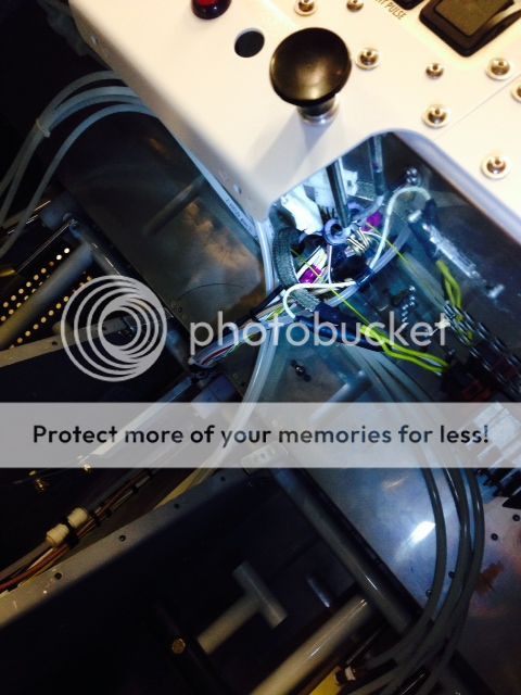

I installed it last week, Regulator cable and WH-p761 Yellow cable go inside through the right side grommet ( grommet for control cables ) and install the regulator next to the fan area.

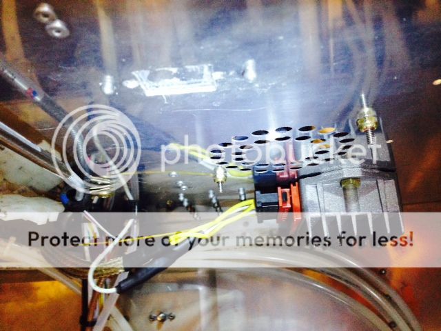

I mounted the new regulator per the revised plans, under the avionics shelf. It seemed nigh on to impossible to me to stuff the shielded alternator cable through the same hole in the firewall as the control cables, so I made a new hole directly below it, and that worked out fine. I printed the drilling template out to scale, and used it upside down on the floor of the avionics bay so I could drill down instead of up. I used heat transfer compound while mounting the regulator, per Joe Gores recommendation.
I checked the area after an hour's flight and the area around the unit was warm to the touch, a good thing, meaning heat is being moved to the larger structure away from the unit. The unit itself was warm, but not enough to burn my hand. Hoping this location is a winner for long life! Surely better than a few inches from the exhaust manifold!

Some nice folks mailed me pics of the new plans pages showing the modified voltage regulator location. Here they are. Sorry about the delay!
