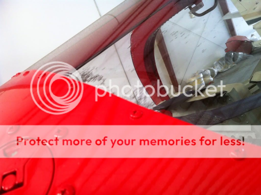

craze-y back window ...
I've about 75 hours on my Hobbs and noticed my back window's craze patterns from about 20 hours. The craze pattern hasn't gotten worse with the additional hours on the Hobbs. The craze "shoulder" areas of the back window run from the top by the rollbar to the bottom where the craze pattern reaches the backmost section of the window where it attaches to the fuselage.
I've tried to fill the tank very slowly ... but still I may get that overflow action. I use all 3 kinds of fuel for my RV-12... 100LL from the truck, MoGas from the gas tank at Lockwood Aviation and auto fuel with 93 octane and 10% ethenol ... I've gotten quite proficient holding and filling my -12 with a five gallon red plastic gasoline "can" and a funnel.
Here are the pictures of my back window ... as with a tiny ding here or there on my -12, I try not to sweat the small stuff (I'm not always successful).:rolleyes:

Geez Jerry, that is a starnge little pattern. That's too bad. Can you tie it back to any particular incident so you can tell which type of gas might have caused it?
lexan and it's wonderful properties eh?
...sorry guys, I have to report that cold formed lexan can 'craze' without much apparent cause. The windshield of our Jodel did it several times, even though we covered it, and it wasn't flown frequently. It was not a radical tight bend; actually looks a lot like the rear -12 application.
It eventually broke along one of the crazelines when I was polishing it enthusiastically.
The lexan 'dries out' and loses some of its properties. Most manufactured lexan sheet is actually intended for hi-impact glazing, ( flat, properly suspended), not cold forming a bend into it!...or drilling a lot of holes near the edges.
if properly dried and heated before forming, it will react quite differently...although that process induces a whole other suite of possible effects...cooling & tempering stresses etc.
