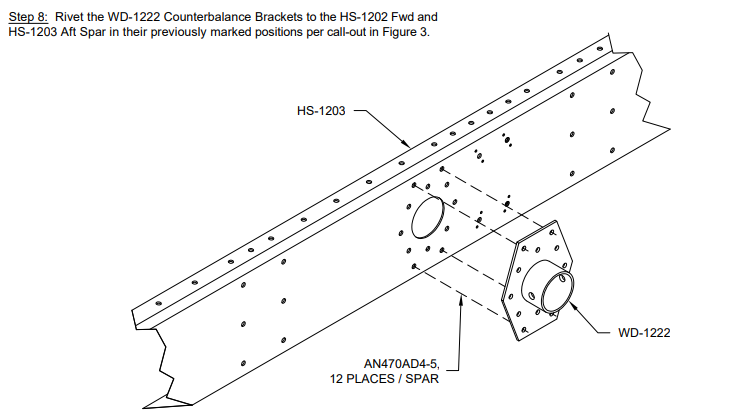

On page 9is/U-04 of the empennage kit, Figure 2 shows riveting the WD-1222 to the HS-01203-1 using AN470AD4-5 rivets. I somehow missed that note and used the LP4-3 blind rivets instead.
The entire stabilator is complete and I have no way of changing those rivets with the correct ones short of completely disassembling the stabilator.
Please tell me it?s ok as is or there is a corrective action that doesn?t require disassembly of the entire stabilator.
Ouch. (drawing below so everyone understands). Best case is that Van's MAY ok drilling out the LP4-5 and have you use CherryMax CR3213-4-xxx -- which may be 4-2 (grip range .063-.125) or 4-3 (grip range .126 - .187) instead of the AD4-5's (grip range .114 - .134) .. I'm not sure of the actual material thickness there.

I was just rechecking my work after seeing some of the notices about cracks in the stabilator hinge brackets when I noticed some of the pictures in the RV-12 Builders Blog showed a picture of the section in question and I noticed my rivets were different. I have no idea how I missed something so obvious. Brain fade is my only excuse.
I'm hoping the fact that the counter balance tube goes thru both WD-1222 counter balance brackets and then the tube gets secured to the brackets with two 3/16ths AN bolts and nuts. In other words, the brackets that hold the counter balance tube can't go anyplace once the counter balance tube is inserted without first shearing off 24 blind rivets (12 on each bracket). I would think that's near impossible but I won't let it go unless the mother ship says it's OK or gives me a workaround. I'd really hate to have to drill out about 1000 rivets.
Per page 17-3 of the RV-12 Maintenance Manual ?Cherry Max CR series rivets may be substituted for any AN470AD rivet or LP4 rivet.?. Looks like the best approved path forward.

Holy cow... Vans support got back to me almost instantly on my followup question.
Here is what they said...
The engineers will accept the cherry but a pulled rivet has a higher tendency to work loose than driven rivet. The cherry rivets are also much more particular about hole size. These could be used in place of the 470 rivets providing your hole meet the required cherry rivet specifications for hole diameter.
So it looks like you were correct... the Cherry Max rivet is an acceptable substitute.
The only question I have left is which Cherry Max rivet to order. According to the charts I think I'll need a dash-3. The dash-3 has a clamping range of about .126 thru .187. The thickness of the WD-1222 is approx .090 and the HS-1203 spar is approx. .040 giving a total thickness of .130. Does that sound about right to you?

I think you may have misunderstood which connection we're talking about. The WD-1222's hold the counter balance tube, not the stabilator.
Also, the WD-1222 is getting riveted to the .040 aluminum of the HS-01203 spar, which is probably why there are 12 rivets each on the front and rear WD-1222's. How strong does a rivet need to be that is connecting something to an .040 piece of aluminum?
There is something that is a bit confusing to me though... The WD-1207-1 and the WD-1208-1 (the stabilator control horns) do carry the stress of the control cables moving the stabilator and those two brackets get riveted to the same spar as the WD-1222 but with BSPQ-5-2 blind rivets. The difference being that the WD-1222's get riveted before the spar tube is closed and therefore you have access to both ends of the rivet which means you can use an AN470. However, the WD-1207-1 and the WD-1208-1 don't get riveted until after the spar is formed into a box and there is no access to the shop head side of the rivet for squeezing, so a blind rivet or bolt into a nut plate would be your only options. The plans call for BSPQ-5-2 blind rivets for the stabilator horns. Curious.
Back in the old days (like 2 years ago), the control horns were ONLY attached to the sparbox by (4) AN3-4A bolts each. Then they found some cracking of the spar around those bolts.. so they came up with a retrofit for basically every RV-12 in the air (with the stabilator closed up)... my guess is it was simpler to take those same instructions and incorporate them into the KAI.. rather than come up with some sort of different plan that takes advantage of the open box.
