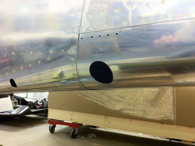

As I am building a 8, with a tailwheel - why have I got this hole in the fuselage ?
For the step???
For the rear vent scat tube???
Show more of the side, so folks can see where the hole is located.
(My bet is step)
its for the step for the ones with the training wheel on the front. rivet a plate on the inside (with a bit of proseal) as the flap fairing covers it it cant be seen

Well - it is exactly where the step would go.
I am just surprised that there isn't a reference in the instructions to a cover plate or something.
I can see the efficacy of using the same parts on 8 and 8A but until I get closer to the finish, I am not sure where the flap fairing goes.

if i remember rightly the line of rivet holes on the left of your picture will line up with the holes on your flap fairing. that should give you a rough idea of where it goes, final positioning is done when you put the wings on and line the ailerons and flaps up

huge draft if not covered
There is no reason to do anything with it. The fairing will cover it......build on.....
The flap fairing is open. If you don't make a cover for that hole, it will be pretty cold in the back seat. (It kind of is already - do everything you can to seal up holes to the outside, namely fabric sleaves to seal where the aileron pushrods and the vent tube come into the fuselage.)

Looks a bit like the hole I put on the fuse of my 8 for the step.
FWIW, as I get older and the knees get creakier, I decided to put a step on my tail-wheeler to assist with the climb from terra-firma. Have seen a couple with the step.... no ground clearance issues and a nice easy transition to the wing-walk.
