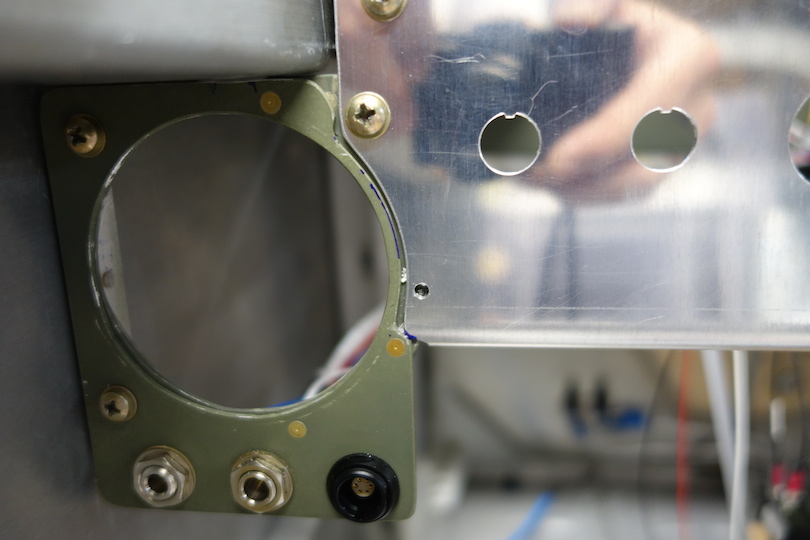

Canadian_Joy said:
This means we have to drill the small hole for the anti-rotation tab opposite the normal orientation for our ignition switches.
Is it just me or do others just snip the anti-rotation tab off their switches as well? I don't find my switches rotating after installation. I have a socket that fits over the locking nut on the switch, that was ground flush so it would grab all the way into position flush against the panel. With that, i've always been able to lock the switch in place so it wouldn't turn.
I think the bodies are too close together behind the panel to allow one to turn more than 20 degrees or so... So I wouldn't lose any indication of which way the switch is turned, even if it did come loose.

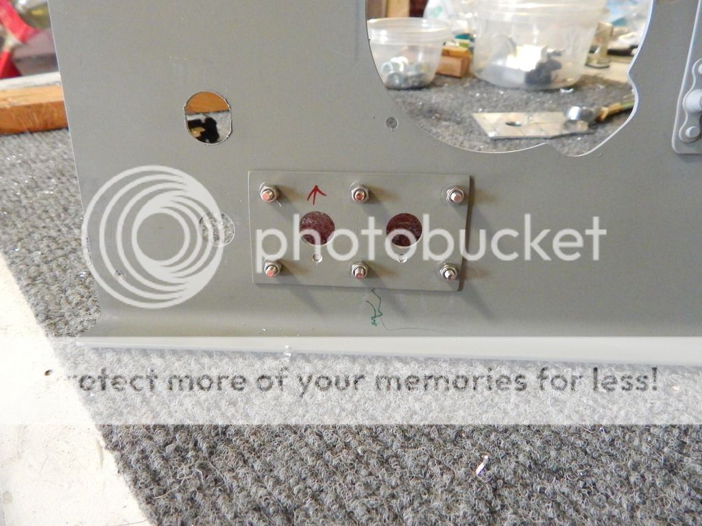

I installed a small 2-hole doubler plate behind the mag switches on the right fixed portion of the instrument panel. The anti-rotation tab engages the edge of the doubler preventing the switch from spinning even if the nut loosens up over time.
There's a really neat trick to dealing with these anti-rotation tabs if one is fabricating a panel and has good access. If one uses a small-diameter cutoff wheel on a Dremel tool, one can make a 1/8" wide divot in the back side of the aluminum panel with its depth controlled by the radius of the cutoff wheel. The anti-rotation tab will sit quite nicely in this little slot in the back side of the instrument panel. When the nut on the switch is torqued, the anti-rotation tab will bend backwards slightly since it's not protruding through the entire thickness of the panel.
This technique allows the switch to be free from rotation while the face side of the panel isn't marred by the appearance of the anti-rotation holes.

Or, backing plate with locating holes. This is my ignition or mag switches. Haven't identified an engine yet. Before I installed the panel I drilled locating holes on the opposing side so I can be either mags off or e-mags on just by turning the switches over.
