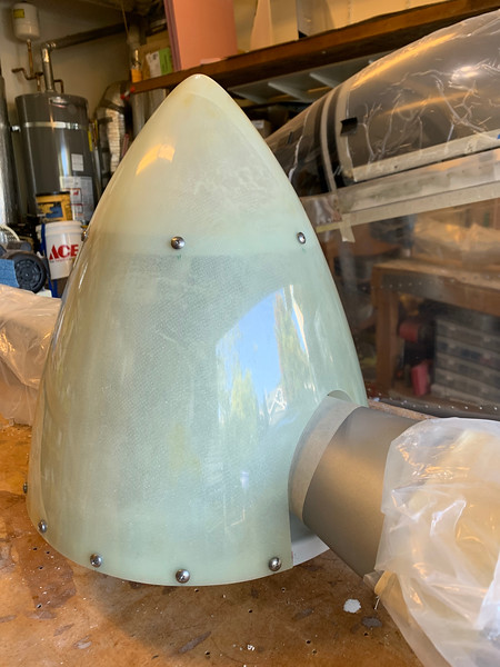

When I've got everything perfectly (or as perfectly as I can manage at least !) aligned I drill 3 x 3/32" holes at approx (buy not exactly) 120 degree intervals through the spinner moulding and into the back plate (paying attention to hole edge clearance in both parts of course).
The logic here is 2 fold
1) When I re fit the spinner after prop bolt torque checks etc I use 3 x 3/32" drills as "index" pins to hold the spinner in exactly the right place as all the screws are all tightened. Once all tight I simply remove the drills.
2) With the 3 holes not being at exactly 120 degree intervals the Spinner will not fit on the index holes unless it's in the "correct" position. Murphy states that if it would fit in 2 orientations (ie 2 blade prop) unless checked it would inevitably go on the wrong way .......

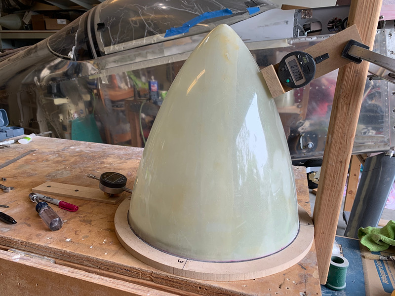

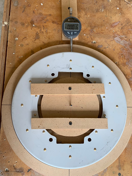

I used MDF to make a rotating platform and then used some dial calipers to set up my fitment:
1) Center the flange on the rotating base. The axel is a #30 drill into the bench. Runout was < 10 mils.
2) Use an upper dial caliper to center the spinner. Measure and sand the edge of the spinner to get it to center. < 15 mils all round on the upper caliper when done.

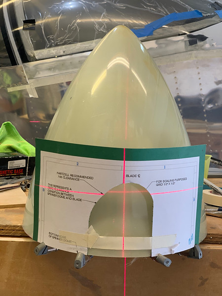

3)Used the Hartzell pattern plus a laser level to mark the edges of the cutout on the spinner.
4) Looking good with the prop attached.
