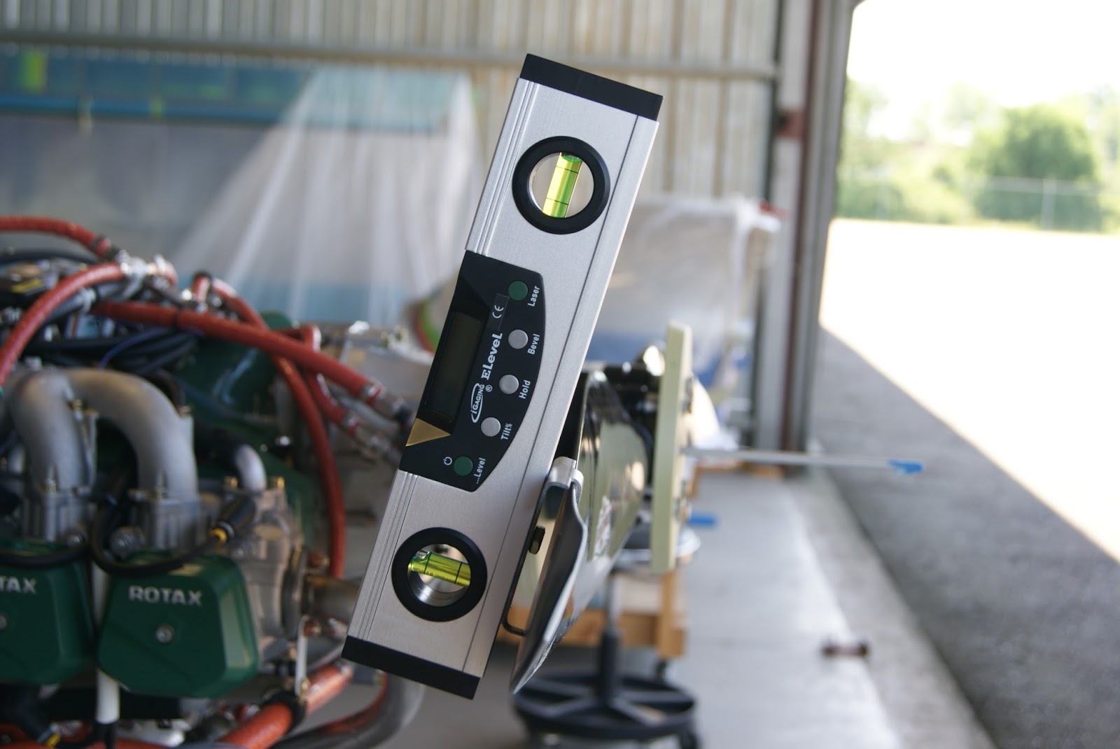

Use a level with a tripod mount
Ill look for a better digital level.
Seagull - If you decide to purchase another digital level, consider purchasing one that has a threaded hole in the bottom for a tripod mount. Mine has a 1/4-20 threaded hole on the bottom (probably because it also has a built in laser) that I use to secure the level to the Van's prop tool .... just drill a hole in TOOL-00002 and mount the tool onto the level. No need to worry about having good magnets on the level or accidentally bumping the level causing it to fall off the tool. Below are a couple of links to photos.
