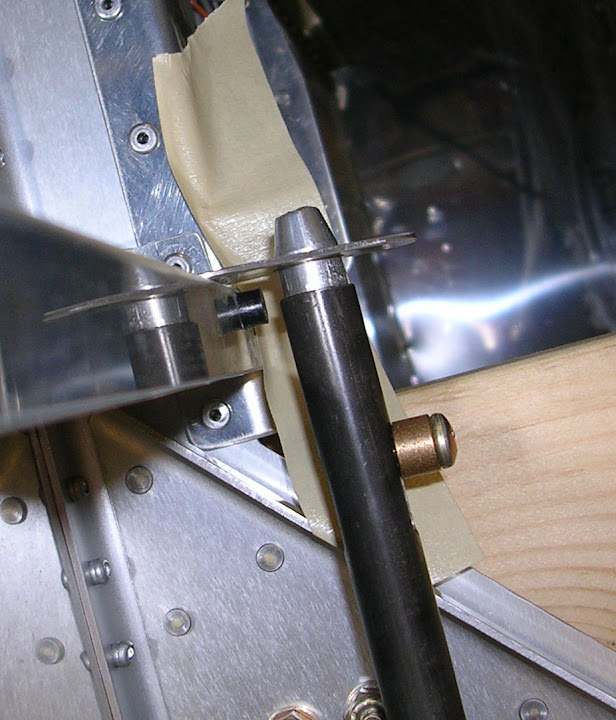

31-06 reed switch
Here is a picture of my reed switch. Notice that the top of the WD1217 tube is centered on the reed switch. Also notice that I mounted the reed switch as high as possible. If you are wondering why I replaced the aluminum spar with a wooden one, I prefer wood. :D Actually, it is a 1x8 from the crate that is protruding out from each side of the fuselage and is resting on concrete blocks. The 1x8 also makes good handles for lifting the fuselage. Joe
thanks for the picture, Joe
Great picture Joe ... but still no light with all in place. I enlarged the rivet hole and slipped the reed switch thru the armrest (flush with the armrest ... didn't have the room to slip it thru as you did ...my WD1217 was too close in).
For now I'll just pretend it works properly and continue with the build. Spent way too many hours on that gizmo already. In time, may figure out a solution ... just not now.
