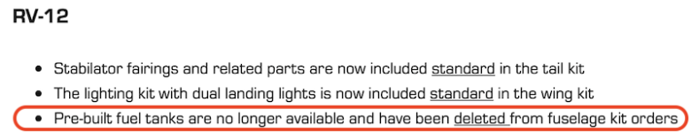

For those building now, the choice is a lot easier. With the latest changes, the factory built fuel tanks are no longer an option.
