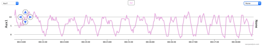

PP 60Amp, Earthx, GRT EIS 4000 w/hall effect sensor on alternator B-lead, running all lights, etc. Steady state getting these kinds of fluctuations both voltage and current - is this "normal"? I have not yet tested without the flyleds wigwag lights or strobes or position lights (which are awesome, by the way).

Looks like you have two waveforms with zero cross-correlation. Within each waveform there is strong periodicity.
I would start with the current pulses. If you have no cycling loads, then the Earthx BMS may be cycling. Ask them for more insight into their charging algorithm.
As for the voltage oscillation, any kind of resistance/bad connections in the field circuit can cause this. This is the fundamental problem with internal regulators, and some simple external regulators.
As for being abnormal, what is normal for your aircraft? Is this a new install?
Vern

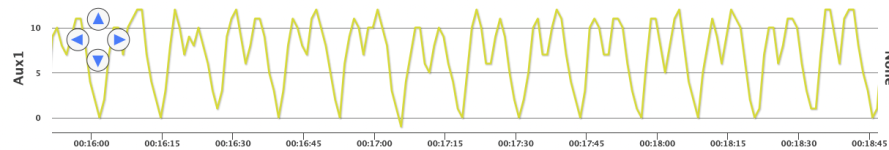

lights off test
Powered off all the lights and the current shown from the alternator did go down - no surprise.

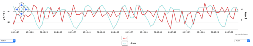

Looking at the graphs with everything on (except fuel pump/flaps/trim/AP servos) there seems to be a regular pattern.

Thank you Mickey for reaching out to us at EarthX with your questions.
The battery has no built-in charger or charging algorithm as suggested that could cause this issue. Based on the supplied graphs of voltage levels, (12-15 volts) it is no different than a lead acid battery.
Based on the supplied trends, the current and voltage are not in sync, so this is not a battery issue and there must be some load on the aircraft.
If it is battery influenced/related issue (any kind of battery) the voltage and current oscillations would be in sync. That is, if the alternator voltage increases, then the current from alternator would also increase because more current would be “pushed” to the battery. As voltage out of alternator decreases, the alternator current would decrease for the battery would supply more current.
Not the battery

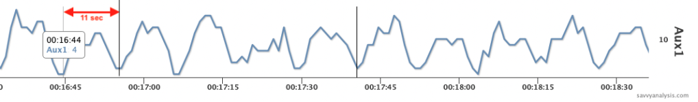

Following up on this, Plane Power/Hartzell generously sent me a new RMA alternator and I get the exact same behavior. I hesitate to call it a "problem" since the alternator is charging, just doing it in I believe a strange way.
Here's the waveform from yesterday's flight - peak current is 15 amps, lowest is 4 amps. The period seems to be just over 11 seconds, and is very regular. I'm not aware of anything running in the aircraft with a 11-12 second period.
Happy to get any ideas.
More than likely an indication issue, install a regular shunt.
I am with Walt. Don't see how this can something in your elec system with most things turned off and across two diff alt's.
I have an EIS and find some movement of the current reading, worst when strobes are on. My fluctuations are nothing like yours, but they are also not rock solid like the Garmin and Dynon that I have seen. I wonder if there is an issue with your EIS or the connector plugging into it.
Larry
You would definitely see a voltage fluctuation with the current going up and down like that so it's likely an indication error.
Probably a bad hall effect sensor, or voltage induced into the hall effect sensor wiring from other wires running in parallel with it. Use twisted or shielded wires for the sensor and don't bundle it together with wires carrying a lot of current.

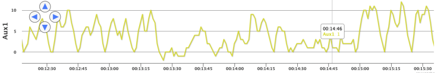

I'm still in the same place. I picked up a DC current meter from amazon but have not yet tried it with any of my systems. Won't be that easy to do since I'll need the engine running to test it. Here is a sample from my last flight a couple of days ago. Very clear pattern here.
The EarthX team commented that they can't see how this pattern is related to their battery. As a reminder, PP also recommended a new alternator, which they sent to me and I have the exact same pattern. Struggling to see how this could be an alternator fault. It could be a problem with the hall effect sensor - probably should just order a couple of new ones - they are not that expensive. Please let me know if you discover something!
Paul from flyleds also said he didn't have anything happening with his LEDs that could cause this. Also, it's the same with wigwag on and off.

Couldn't you start the airplane, then turn the master switch off and see if it goes away. Turning off the master should open the main contactor and remove the battery from the equation. With the battery disconnected you get a good idea if it's having any impact.
If the voltage remains constant at 14.2 volts, then the charging system is
working perfectly. Any fluctuation of current is due to either an indication
problem (likely) or a fluctuating load (unlikely).

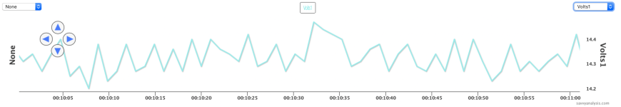

Voltage fluctuates slightly, between about 14.2 and 14.5. I see a dip in voltage just after start while the battery tops up. Here's a short extract during "stable" conditions.
