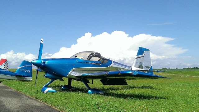

My fuselage is painted but the wings are polished. I believe it's the only RV-12 with this look. Happened almost by accident, my painter could not finish the job and eventually I found the combination quite attractive. Indeed polishing the wings is much easier than other surfaces, specially as they are easily removable. I thought that if I didn't like it I could still have them painted while the opposite is not possible. After one year, so far so good and no problem with the sun as mentioned by some in this thread (when flying I have more interesting things to do than looking at the wings :cool:).

You put a nicely polished plane next to a nicely painted plane, and people will gravitate to the nicely polished plane every time.
Every. Time.
