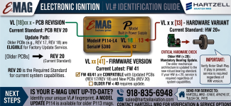

An easy “is my pMag up to date” gouge sheet will soon be available. Here is a sneak peak. A sheet for six cylinder pMags is also in the works.
Just like Van’s and Lycoming service bulletins pMag updates come along. I just verified the two six cylinder pMags I have on the shelf have the latest firmware and hardware updates. Engine hanging coming soon (after a two year delay…).
700 hrs on my current ride’s dual pMags - and they have been flawless. An early version of the 114 series has been running on my first build for 22 years and it just rolled 1800 hours or so. Last year one got sent in for the hardware update. I suggest 22 years of service is not bad….

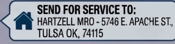

Interesting. So Quality Aircraft Accessories (QAA) is now the Hartzell MRO.
"Quality Aircraft Accessories (QAA) is now operating as Hartzell Aviation MRO – the maintenance, repair, overhaul, and distribution division of the Hartzell Aviation family."
