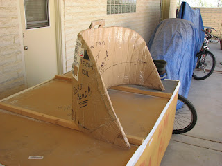

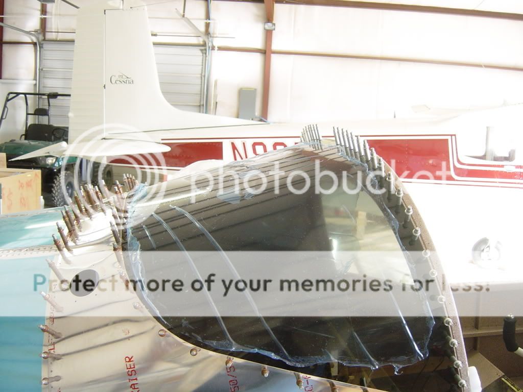

Plexiglas Window
Carl is a joy to do business with. The window is perfect and his instructions are great and he responds immediately.
Mine went in very easily and I love it!

Plexiglas Window Delivery
Carl personally delivered my rear window today, used his "air freighter" service, which doubles as his beautiful RV7a!
