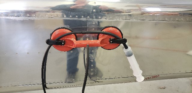

Here is a simple rig to check for static leaks. Harbor Freight parts and some assembly. I just used this on the new RV-8 project to verify the system tight - and sure enough found a fitting not well seated. A few minutes later it was fixed and saved me the pain of paying to get a failed pitot/static check.
Credit goes to Tom Doran (N716RV)

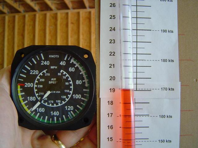

For pitot I use a $4 manometer to verify airspeed accuracy and pitot line tight. This setup is amazingly accurate. Use google to find the PDF file for the airspeed grid.

Carl, how does the black tube from the syringe connect to the static port? I don't imagine a simple suction cup will seal over the pop-rivet static port. It looks like the dual suction cup lift handle is just a support to hold the tube in place?
Does the dual suction cup lift clamp down enough to push the end of a rubber tube up tight against the static port?
The suction cup is a standard one you can find at most hobby stores, Walmart, etc. Drill a 1/4? hole through the center of the cup, slide in a piece of 1/4? tubing and add some RTV to make the seal. Drill a 1/4? hole through the suction cup holder for the tubing. Now add a spring between the suction cup and the holder to press the suction cup against the fuselage. Add a rubber hose to the tubing and then your suction source of choice.
