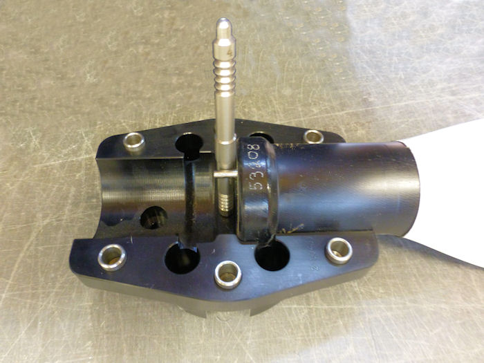

I sent my Sensenich two blade prop back to Sensenich for upgrade to the new hub and settings. Essentially you are furnished a set of pins which you stick in a hole of the new hub, then rotate the blade until the newly installed pins installed by Sensenich contacts.
I cannot find anyone in the archives that has done this, and I was wondering how well this new method gets the blades equal with each other, and which pin others have found to result in the most favorable pitch.

Stretching my recollection a bit but I seem to remember starting with a number 3 pin. That only got me in the ballpark and I used a digital level and Van's fixture to fine tune it and get the blades pitched exactly the same.

As Tom mentioned, pin 3 is the recommended starting point.
The difference between each pin # is quite a bit so most people end up somewhere in between.
Since a smooth running engine requires blades to be pitched within .1 degrees of each other, you have to measure it. Neither the old style or new style hub gets the blade pitch relationship accurate enough.
The sheetmetal gauge from Van's, when used with a precision digital level, works very well to set blades within 0.1 degree pitch.
I have my blades set at 71.4 with the Rotax 912 engine. Performance matches Van's published figures and engine/prop run very smooth without need for dynamic balancing.

That's still a little course (over pitched).
Ideal WOT RPM, at your preferred cruise altitude, during straight and level flight, should be about 5650. That will also give you a little more RPM for your climbout.

The current Rev. KAI section for propeller installation mentions using pin 3 as the starting point.

From my experience, anytime a propeller is removed from an engine (Rotax, Lyc., etc.) and then reinstalled, it will have some level of influence on the overall balance and that rechecking the dynamic balance afterwards is typically warranted.
If that wont be possible, you can label all of the parts positions so that is gets reassembled with the blades and the spinner reinstalled in the exact same clocking positions on the crank shaft and see what happens. If it feels as smooth as it has previously then you could just leave it as is. If not, then finding someone to check the balance would be a good idea.

Also keep in mind that a very close match in blade pitch has a major influence on smoothness. Doing a dynamic balance without confirming that the pitch of the blades is within .1 degrees of each other is a waste of time and money.
Sensenish sold me on their idea that the old nylon button was not accurate, but that the new pins were to be totally accurate. I guess that is not the case. I have the Sensenish blade angle tool, guess I will have to fine tune the settings that way.
I wouldn't even use Sensenich's blade angle tool. I would get the sheetmetal pitch gage from Van's. Very accurate and repeatable...

The pin setting method is in my view as close as 95% of the all the props set with a gage
The pin method is designed to change two inches of bite in one revolution .
If you want something in the middle you can turn down the larger pin to the one half the difference in the next smaller pin.

I have seen, felt, and measured the vibration difference that more than .1 degrees of mismatch makes.
I have also measured the blade pitch differences that result from just using the pins on quite a few different props (Van's flight tested one of the early prototypes, and has sold more than a few S-LSA's so there is experience with a lot of different props.
The very first S-LSA's did not get the props Dyn. balanced, but they have been for a number of years now (not sure when exactly it was started).

It is not difficult but is not necessarily done in 5 minutes.
I would say that 95% of the props on RV-12's where the owner has experienced and learned the smoothness difference are set within .1 degrees (many here in the forum have mentioned it in the past).
Will the engine run ok with a difference of .3-.4 (fairly common if just using the barrel or pin indexing system)? Sure. But it is not worth compromising when dealing with airplanes.
