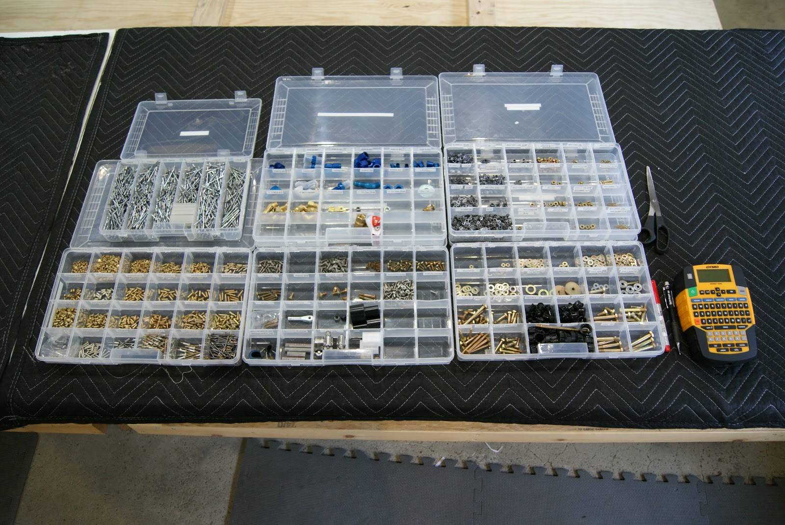

Gandalf and others - respectfully - there is a MUCH BETTER WAY to do this and save you many, many hours of trouble.
One of your most important TOOLS is this. Buy 4 briefcase size plastic sorting bins - Harbor Freight or a big box store. The kind that close like a briefcase and contain many individual compartments or removable bins.
Inventory your bags of small parts and put each different part into a compartment labelled with its PART NUMBER. DO NOT KEEP THEM IN THE BAGS. YOU WILL NEVER NEED TO REFER TO THE BAGS EVER AGAIN!
If you organize your "briefcases" well you will not need a computer list. The plans show a screw of some sort - you will quickly learn where the screws are! You will know those cases like the back of your hand.
Do not mix parts in the same bin that are the same "thing" - like different size nutplates. You can mix different "things" like one size of nutplate and one size of cotter pin.
This method will save you MANY HOURS. Many advised me to do it this way and I am glad I did.
If you get another subkit before you are done with the last, just inventory and add the new additional same PARTS into the appropriate briefcase bin with the ones from the kit you have not used yet..
The "briefcase" is in this post.

Use storage containers
Ditto Bill?s suggestion for the small hardware. I found some inexpensive partitioned parts containers at Harbor Freight and while watching TV in the evenings completed the inventory counting and filled them up based on the type of part ?rivets, electrical, fittings, screws, nuts, bolts, etc. It has worked out quite well and has only required minor rearrangement of parts as new kits arrived. I used a Dymo label maker and made identification labels for each bin. Sure it takes some extra time to do this, but it pays off in spades later. When you need a nut, bolt, washer or screw they are all in one place and clearly identified.
