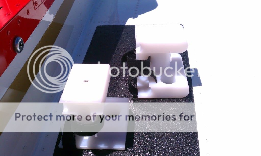

Search the forum for my appends (engineerofsorts) . I fabricated some snap-on rudder pedal extensions from UHMW plastic. From the pictures, I haven't figured out exactly how the Van's version, which are all metal, are installed or operate.

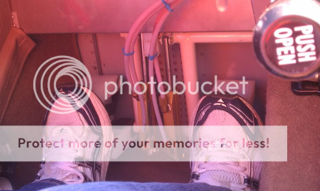

I'm about 6'0", while my pilot wife is 5'2"-ish. The more important metric is the buns-to-heel distance: Sitting on the floor with your back and buns against the wall, the distance from the wall to the bottom of your heal seems like a good measure of the need for rudder pedal extension. For me, this is about 48", while my wife is at about 38". For me, I'm comfortable as-is with the seat back in either of the two hinge positions. For my wife, she has both the rudder pedal extensions, which add about 2.6 inches (on top of the approximately 1" already there with the black UHMW blocks that are standard on the rudder pedals) to the rudder pedal and 3.1 inches to the brake pedals. With the seat back hinge in the forward position, she still needs about a 5" thick pad added to the seat back cushion. (An added seat back cushion can be purchased from Abby at Flightline Interiors--tailored to the needed thickness and matching the original fabric).
The problem with too-thick an added seat-back cushion, or adding too many additional seat back hinge points is that you reach a point where the belly-button-to-full-aft-stick distance goes negative. My wife's circumference is considerably smaller than her height, so this hasn't been a problem. Just adding more forward hinge points poses the above belly button-aft stick problem, but added to it, moving the metal seat back forward also moves the seat bottom pad forward, possibly causing a stick-to-pad interference before the belly button-to-stick problem occurs. Furthermore, the seat back becomes more reclined as the hinge moves forward.
The other minor problem with my extension design is that, with the extension of the rudder pedal, when the brake pedal is pressed, the aft end of the rudder pedal will also rotate upward. My wife hasn't issued any complaints about the effect, and is should be minor since the brakes don't move very much. I can't tell from the pictures of Van's extensions, but I do see some hinges in the picture, so I'm wondering if that design incorporates some mechanical magic to keep this elevation from occurring when braking.

The safety of adding anything to primary flight controls is well noted. Looking at the pics in the FAA investigation noted above, it looks like that aircraft's extensions were quite a mechanical contraption. I was very concerned when designing extensions that they could fall off in flight and jam the rudder controls. As the design evolved however, I found that, with the UHMW milled to wrap half-way around the rudder pedal, brake pedal, and the pipe connecting them, along with the spring clip firmly holding them on, they just don't want to come off without a firm pull directly aft. I'm still paranoid, so I included velcro straps to further hold the rudder pedal portion to the extension. The pedals are the same width as the existing weldments, so I see no side-to-side interference, and there is no added material on the forward side of the pedals (except the thickness of the velcro safety strap, so it doesn't limit the full travel of the rudder.. It appears that Van's followed the same philosophy on their extensions, and made the whole works lighter with aluminum.
