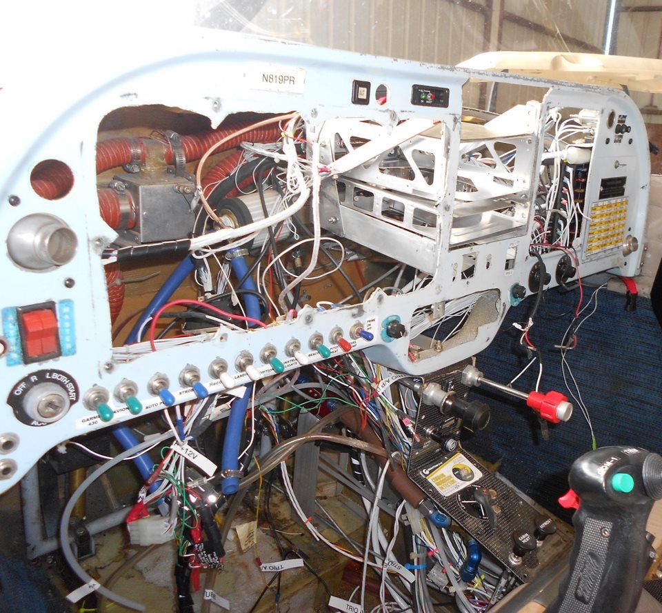

After 15 years and 1540+ hours flight time, in October I started on an upgrade which will include complete modification to the electrical system as well as new avionics. This picture, at first glance, appears to one of an airplane wreck:
l6-gtvg38t8oW8MMUYB2HU_o4AcsWF0CfaKrnNqP86rsHILHDT7GwIB7HhB-w2m1VurNI_m0pzY9HamoT5LlAn8yCHAW1OkDLZVzM_vfETnJidVdosH-T1d-3VjiKfLzsuq_qj_nWFzds1IJ--73F6qCnkrHVaOmgDFN3BVX2XeVgSHf9vGvkdejaC2K01KrnGckfK6sqLFdRWbPpo7ZHkBwZLV7sQBF30IRUxcoBC4mS4khoAIL6rKgB2TK1TVeiv2OcAlSv3oafNePmVZvmn33Llt2Hje-z8k1dDrJRLJdX91poUdkeCyk7XwHAPhEIm8Seuu4cAar2_-w5XjcbUBvM_TJPk3nYYggk56vsu3ge_Wj-OiRbBVoNWBY86ydWAWZfa1Y92TYJwC-Pt5HzKPNzf2HGv_es0LzUOPJtQebSF4o3B7d9-8YG9tc6E2L2F0aIwRINeWFogWeU_mdMbl6GAJS9Rzi6CYeVE2QVdh7vgNFSOHUSGsq-epICcBvzwcTWIwSMlM8h5LaB1wayN4yGYrnv7PSF3yAjs4BjPP1KCTb4jO2P8xC-GgOD_3vgeGsBJFCgZz6DQw0xZ7cWbvEhzUAXzNoaiz0a_w-VizKYTbJh_L1=w640-h470-no
Unlike during the initial build of the plane, where I mostly worked on one system/component at a time, this project requires a lot of simultaneous sub-projects at once, hence the huge mess...
The electrical system changes include: battery moved to forward of the firewall, solenoids ditto, fuse and grounding blocks moved from near the firewall (inside) to between the panel and sub-panel.
One finds that maintaining an RV for 15 years greatly increases one's wisdom about what to place where... A design goal for this project has been to eliminate the need to climb under the panel for most things. I'll post pictures as I progress.

Mickey, thanks, will do. Here is a picture taken early in the process, just as I was getting into the teardown. This would be the "oh, s***, what the **** am I getting into!" phase:
R9noUl6MnXUOUd2_iUTsw572scnhYCD97PWO-dy8V8CsDXml6UPr1w3LAereDkMIUbLAJbOrzrQvnGLN9UswTmG5IliHhGrZQJs1J465dh0sFVXXpSdIS12JKHY6zHDR3mAXNW59o7Qe8tFk6Sl-pzl_PFiKaam1DODD3Xe4j04zjGQAKHH87kWhk8kmBOrPNwg6Zfb1m2uSouBnnD9vsSffIuX7nJRga0vxxTZubgdUizqlJTqMxTe4yqeiLwDRd8LWqCdEUtDMFDXe12JX8MtuHf3GnbymbXHM_H6OiZz5vqkiGxZM3IG2dzGvam476oaJpw9Zsmqx-3qHnGAICYqulzG3IObaamYib6cSF8ILApvwfP7g4jlkHDHhKbh7R8UkXsf7n3uAYbI-62BdLP83LRJQHxfTSxr_nP-s5Myt0dPzDt3Wt5TzVmx7j94Tmdu3BynjE9xDBLnvFWXOk3lYI6XleCOok0aWilJt9l8NbnXM60X6t7IfqbheVrlRldFGursqXetkcvW_VARW3soKvxR4dF6i_adf2UWwcfky2-ArjuBdTb0A-_EB2JlnpEu76A2SLgfjx68q0AcqlUZAsAoW1T_cEojDzDjx37qhR670fWP7=w640-h480-no
I'm 2.5 months and about 190 hours into the project. The majority of work has been re-doing the electrical distribution, planning, design, servo mounts (I had Century servos before, so needed to adapt the mounts). The actual wiring won't take too long. I hope to be done around the end of Feb...

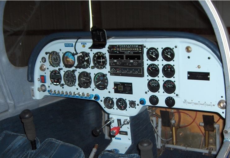

I completed the panel about a month ago. It took a bit over 300 hours, but at least half of that, perhaps 2/3's, was redesigning and redoing the electrical system. More details here if you are so inclined, in the December 2016 and March 2017 editions.
I'm very happy with how it turned out, and I've found no big deal in transitioning to the efis display from the old gauges. I retained the A/S indicator as a backup, but I only look at from time to time for comparison.
I've got a few more labels to modify and/or generate, but here's the final product:
4sr276XZEqZ9Znn4cOBNtB4P4kUKt0JquwdGKTF8_L8FirpGXrvu8mt7B05vh1cZowmr9qbY9legsueVVluDl8uWx-zCkjhvvnDzLYpxJZAUdevVLNt8aXXGM1dv3UTrp6D1VLjbbf4z4ODN5ZN2CEtoIHBMXbFNRxg5aIVCUL7y6kasuB7xK4gyHKPnLlLmkWltlv9e_gMPCXAfL0Aq2NWw5HV95oz0JSZD0qWswfcHXNCTp_SGQQ4NDqn5aQOQdWECx8bqiZ2g1V5-9ufb32_klI-tQP_1bQPj_vFGql-jQ9Qz33NwDd9Z8R7ie_jq7TakmYiJxIKNGZrYEISmt_BuGTL_NyT1u-5hGtPPCwUpRC-IPmE3iJCJK97lnA8uQ_uHVLjIEpcHR26RanlTAmViGBNaF6ahRLa-IcmW2Ui-I9mu9fwePeVkpONBXEav3dFcwoHbDGi9yhKIzB0l9lIrDeDXP5MSx9tmsGlNdrwysObkuJn4VJeG9O6RYg9A8FF8nfUZMO-1erRaQCCRK4V43x5kzYp2duzOyLj18R9Q5PTuI5Y_2rluBrmO5xfKKUr6ttwIA_FF7UBHJS8cqLnqH3ztv3Vvp3xs5JXvqTacSzIUsmo8=w760-h319-no
The goals of the project were met, namely, replacing some gyros and A/P parts that needed repair, ADSB in/out capability, coolness of big screen, etc.. I also had a major goal of making things easy to maintain, specifically minimizing the need to climb under the panel. A few more thoughts are in the newsletter linked above.

Can you tell us more about those red screws? They look cool.
Alex, it turned out really nice - congrats! I guess it feels like a new aircraft, probably flies better, too. :)
Mickey, thanks. The screws are anodized aluminum socket head cap screws from here. Obviously not as strong as steel, but are fun for this application.
