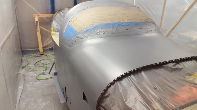

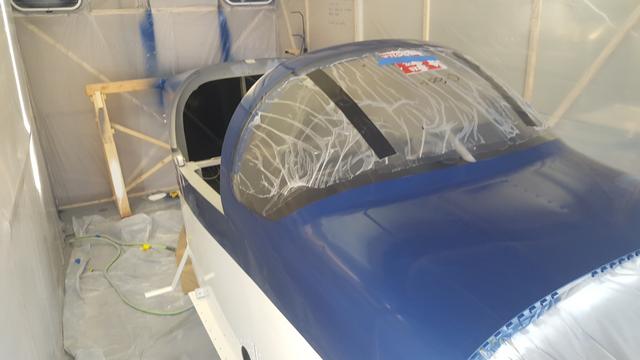

I built my makeshift paintbooth in my garage out of cheap 1x2x8' whitewood sticks. I stapled heavy 6mil clear plastic to the inside of the frame. The floor is also covered in the same plastic. The booth is 8x8x19. 8ft is wide enough, but just barely. 10' would be better. I have two 16" fans forcing air in though AC filters and 4 outflow filters at the opposite end. This seems to work well, but a third fan would be best. At first I mounted the filters on the outside (suction side) of the fans. They need to be on the inside, otherwise the fan recirculate a good portion of the air.

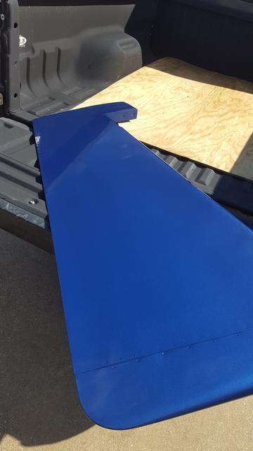

Here are some pictures of work to-date:

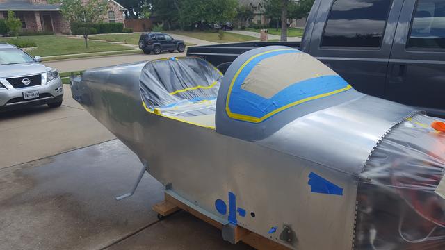

Fuselage metal-prep complete:
Fuselage in Primer:
Fuselage Painted:

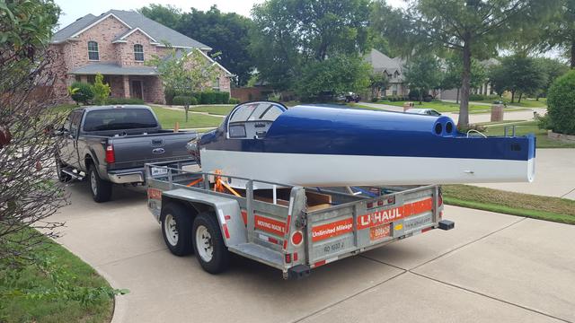

Fuselage moving to the airport:

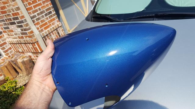

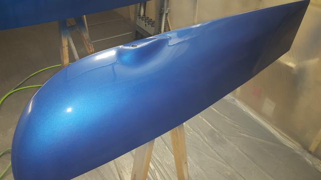

Spinner (nice picture in the sun), this is raw paint, no post processing (polishing etc):

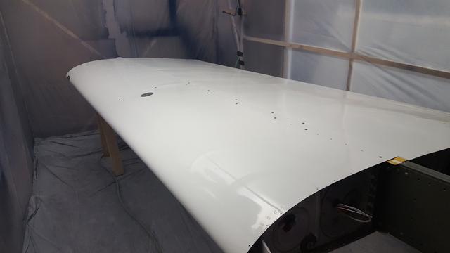

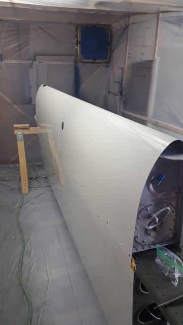

Adding a few more pictures. Painting has been a little slower than I like. It has been raining almost every weekend for the last month and a half, and now it just got cold. Just bad painting conditions all around. But it is done now. I just finished the second wing. Still have to do the wheel pants and gear leg fairings, but that will be down the road a bit. For now, it is time to start bolting this thing together.
Right wing
Left wing

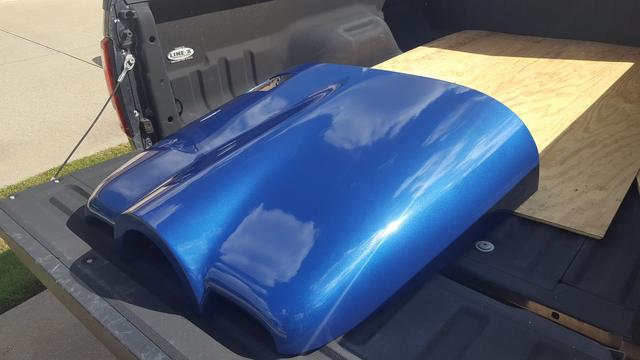

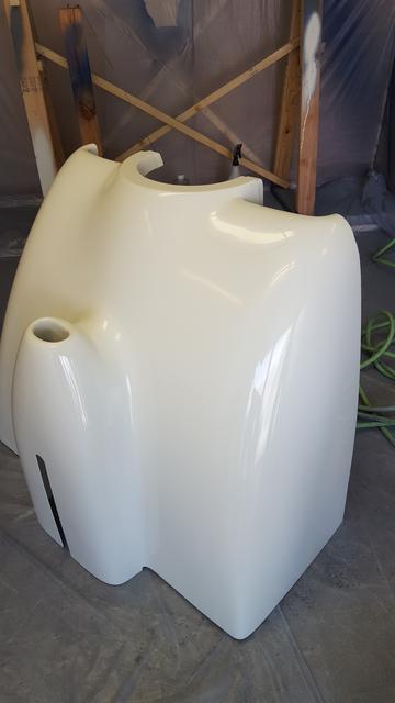

The small parts are easy and came out really nice. The larger ones aren't quite as nice. A little orange peel and some dry spray here and there. The white can be cut and buffed so that helps.

1) Even though I read this myself a bunch of times and was told, metallics are very hard so shoot in single-stage! They are very prone to tiger-stripes and mottling. I was able to get it done, but it wasn't easy.
2) You cannot cut/buff single-stage metallics - even if they say you can, it doesn't work well. So plan on not doing it.

4) More light is not always better. I have overhead lights in my shop and I added 4 2200 lumen LED lights to the sides of the booth. It is too much, it just washes everything out. Most of the time I just turn on one or two of the extra lights. Ideally, you want the light around 70 degrees offset from to face of the part, so you see the reflection at and angle. Straight-on and you can't see a thing (more of a problem with the white).

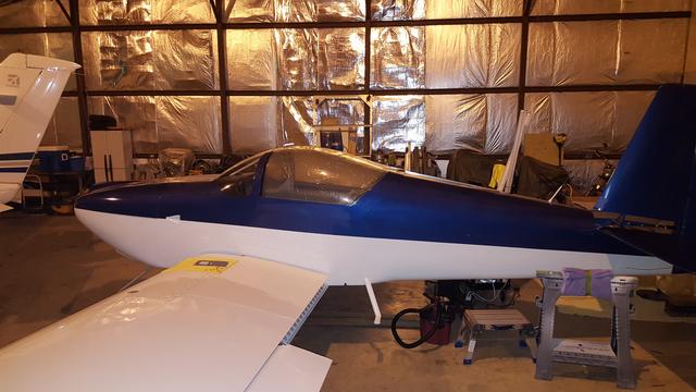

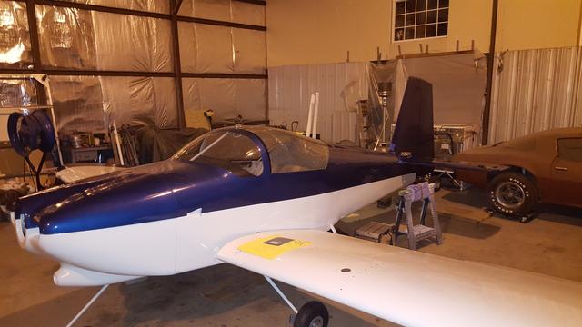

Just a quick follow-up, the plane is nearing completion. This is my first picture with the cowl and canopy on since paint.
Lighting is poor in the hangar, ill get a picture outside at some point
