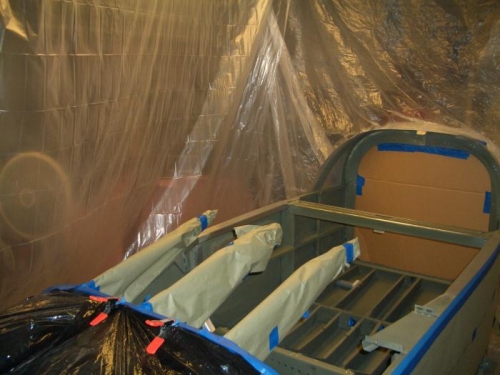

The big day has arrived on Sunday, it is time to paint. The weather has been great the last couple of days. A cold front came through and dropped the temp from 104 down to the low 80s, perfect for me to paint (or close enough). I started early and put together my paint booth by stapling plastic sheet to the ceiling and taping it to the floor. I have a couple of fans to circulate air through the "booth" with cheap filters to keep out the dust. I will be wearing a full-body tyvek suit and full-face mask with the appropriate chemical filters.

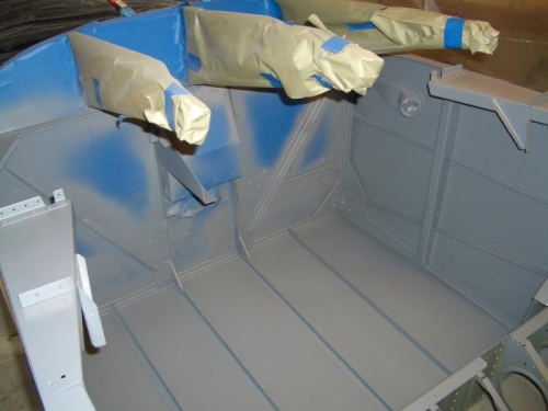

II shot the grey epoxy primer. used the smaller touch gun with the rotating cup for most of the job, it is difficult to get in all the small areas and under the angles and stiffeners. I tried the full-size gun, but it was a bit much. The primer went on ok, but a little thick in some places. Next time I will thin the primer a bit. I let it cure for a couple hours.

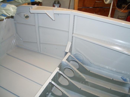

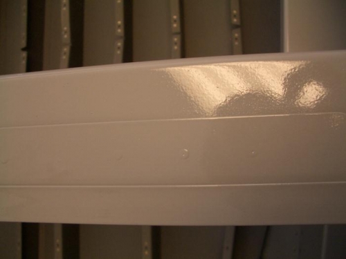

The topcoat was just great. It went on really well even with my poor technique. I used the small "professional" gun with a 1.1mm tip. The coverage was great and it took less than a pint of paint to do the whole interior with at least two coats. The paint covered well even with a single coat. I have a bit over overspray and orange-peel here and there, but I am very happy with the finish. Given the this challenging job with all the corners and hidden areas, I couldn't be happier. I will use the PPG Omni line again, it was great to work with. Now I can be satisfied that I have a paint job that will hold up long-term that wasn't much harder to apply than rattle-can.
Here is the interior all masked off. I masked all the open areas of the firewall.
Paint booth assembled. You can see I used the box my seats came in to mask off the tailcone.

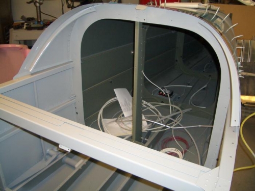

Grey primer is on, looks pretty good so far:

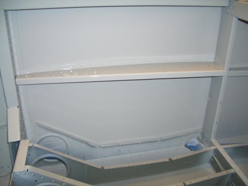

And now the topcoat:
