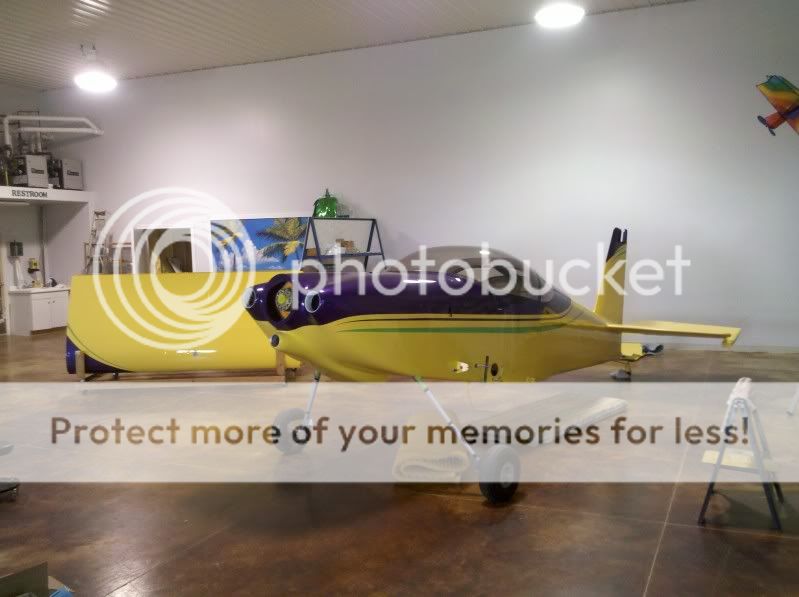

Hi Guys and gals, wanting to get the fuselage on the landing gear. Paint them now or after the build is complete. Not locked in on a scheme, but close. Will probably be white or titanium metallic. First time builder and rusty pilot. Will be hiring the paint job out.
Paint Now or Later?
I painted my RV6 "now" (before assembly) to save money and because of space constraints. There were between twenty and thirty pieces, large and small. Each one needed to be positioned for paint, and to be conditioned, primed and painted. The paint came out OK, I was OK with the process and glad to have saved the money. But it struck me as a very inefficient way to get the job done. I can't imagine paying someone to do it that way.
I had the RV12 painted "later" after I had built and flown it. With the RV6 I was watching my dollars. 15 years later with the RV12, dollars were less important. If you are going to pay someone I would say to paint after flying.
With both planes I had tweaks to do after flying that required paint repairs on the RV6 but that was not a factor with the RV12. Also, I was still tweaking the RV12 paint scheme right up until painting time. I was glad to have time for that because my ideas kept changing.
So if you are hiring the work out I would say paint later.

I'm glad I flew first and painted later. I had a number of little issues that by fixing would have ruined a nice paint job. My airplane is in the paint shop currently and has been there for the last 6 weeks... Going through flying withdrawals in a major way (especially since the weather has been wonderful).
I wrote up my thoughts on my blog about waiting to paint. Hope it is worth the wait!

As for painting, I have painted everything white - except the fuselage. I will be priming and painting as soon as it gets a bit hotter. I hope this weekend.
I was going to paint everything before assembly but the design took longer than I expected and I lost the chance to use a nice auto paint booth. Now I have to build a booth in my hangar. My plan now is to get the fuselage painted white, assemble the plane, then paint the details. I may spray some of the ruby red just to see how cool it really looks!
Good luck. With the right gun, you can paint at any angle so that makes things easier.
Landing gear
If you are asking about the landing gear specifically, then you should at least prime them now with a good self-etching primer that doesn't require a top coat. I primed them and painted with gray knowing that I'll be putting fairings and wheel pants on later. The thing is that there is a significant portion of the gear that won't be easily painted later once they're mounted - and it's the parts you can't reach or see that will corrode first.
