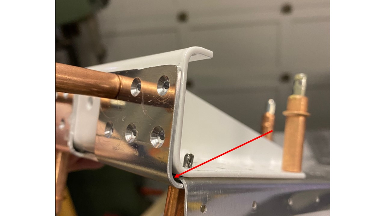

Hi all,
Step 1 requires F-1001E-L, WD-1004 and F-10480L to be clecoed together. However the flange on F1048-L seems to interfere with the flange on F-1001E-L, resulting in the holes not lining up. The plans do call for me to 'file edge as required to nest inside F-1048-L, but the arrow in the diagram points to the wrong place. Can someone pls confirm what should be done here?
The arrow does not point to the spot you should file, only the part.
File the edge the arrow points to to get good nesting, then everything will line up.
