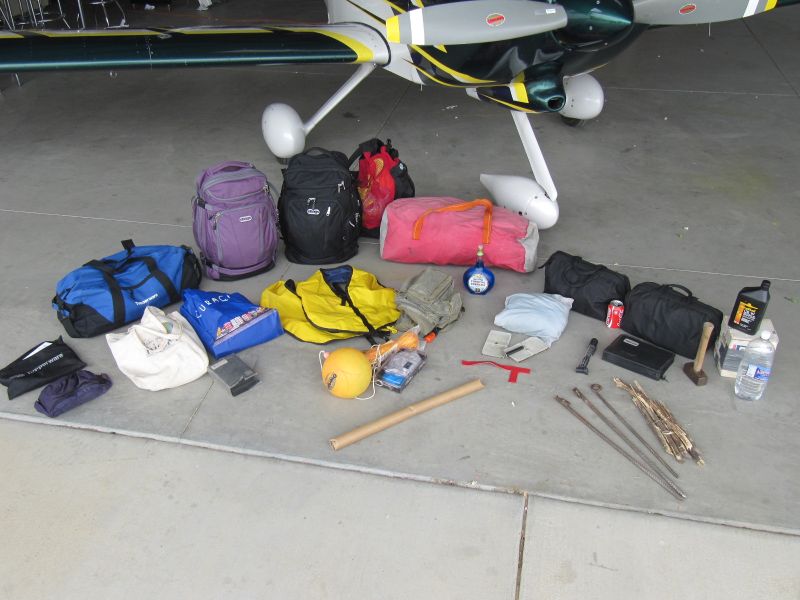

Here's our RV-6A plane 'unloaded' after our one-month-long 2013 Caribbean Trip.
From left rear: Big blue bag is snacks, backpacks for clothes, small red bag is Scuba 'stuff' and big red bag is all my Scuba gear. Black bags are tools, rags, ropes, bicycle pump, hammer, and spare alternator (with oil on top).
From left front: Side-by-side white/blue bags are souveniers, survival gear, Blue CuraƧao liquor, and gray canopy cover. Next to the three rebar stakes are the sticks I used for chalks since somebody stole my nice aluminum ones in Grenada. Lastly, I always carry a cardboard tube on every trip to bring home posters.
For our plane I've learned that if I can fit it, I can take it :D Rosie
Rosie posted a much more informative photo, but i'll add that my wife and I have carried everything we'd need for a camping trip back there... Including a cooler, tent, sleeping bags, clothing, etc. We were packed right to the canopy rails, about 70 lb of baggage total. Another 20 lb went in bags forward of the spar under our knees... There's a lot of space in the -6 when you choose your packing arrangement carefully.

I had my -6 loaded down similarly to Rosie's picture for my recent Johnson Creek trip. Volume isn't so much the issue, but total weight can be, especially if you've only got an O-320 and are heading for the mountains. I was solo, and so could carry quite a bit more stuff. You just have to be careful with the W&B and CG and don't put too many heavy items in the back especially if you've got a wood or composite prop and an O-320.
