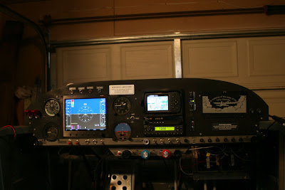

Background: Rv-7, VFR airplane, VFR pilot, Mattituck IO-360 /w 9:1 pistons, Hartzell B/A prop, Plane Power alternator, Sky Tec starter.

AFS 3500 w/ map and b/u battery: Love it! I wouldn’t change a thing. I must admit that it takes awhile to learn the menus, but other than that, I love it. In fact, it does more now, through software updates, than when I purchased it. If there is a problem with this, it is that since Rob came out with the flight director, now I want to upgrade to the AFS autopilot from my ADI PII, and he has me considering upgrading myself and the airplane to IFR status. I am heartily resisting at this point, due to personal stubbornness and potentially misguided beliefs and more $$. I did add the AFS external gps antenna after I was flying. I have called AFS two or three times with AOA issues and software update questions. All problems were builder induced or builder misunderstandings on how the software functioned. The AOA system had a slice in the tubing that happened when installing the wings at the airport. Support was outstanding!
I had to send my TruTrack ADI PII, back right before my DAR inspection. My wing servo kept moving when it shouldn’t. After doing the checks in the manual and calling TT, I made a few other checks they suggested and then I sent the control head in. Lucas took care of me in a flash and I had the unit back in time to get it reinstalled before the inspection. Since then it has just worked great. I fiddled with the settings a bit and had it locked in after the first time and haven’t touched it since. It flies the airplane in turbulence at least as well as I do. First rate Company, first rate service, happy as can be.
SL40 and GTX 327 work great, no issues. I almost went with an SL-30 and now I wish I would have. Is there an SL-30 or 430 in my future? I was and still am on a budget.
496: that little box just amazes me. XM weather – just do it!
Safety trim: Installed it and never touched it since. Works like a charm. What more can I say? Overkill? I’ll let you decide.
Electrical: I had an issue with my stereo audio that turned out to be caused by a soldering iron burning through the insulation. It was hard for me to troubleshoot because the pilot side worked fine and passenger side worked with a mono headset. The issue only manifested itself when I purchased a set of Bose headsets for my wife. Bose helped me troubleshoot and even had me send her headset back in. I finally found the wiring issue and fixed it.
In hindsight, I am amazed that all the wiring works and I have had relatively few issues. For a first time builder, I took a real chance doing it myself including cutting the panel. It is probably the most satisfying part of the build. My rear strobe did quit working recently and it took me a couple of hours to trouble shoot and repair a Molex pin barrel that had opened up, causing an intermittent connection.
I tried installing wig wag lights with Vans 4 wingtip light system. I couldn’t seem to get it to work and gave up. I changed the switch, removed the flasher and went with simple. The wingtip lights are adequate but nothing to brag about. I recently had one of the MR-16’s burn out and couldn’t find a 75W replacement in our little town WalMart or Ace aviation deptartments. I decided to try a 50W flood instead of the 75W spot and I kind of like the results.
Changing the bulbs is kind of a pain. It’s a good thing there are 4 bulbs because I wouldn’t want to try and do it on a cold winter night on a ramp in the middle of nowhere. I finally have the lights aimed where they need to be. I have two switches, with the outside bulbs aimed for taxi and inside set for landing. Like I said, they work okay, but I’m sure there are better alternatives.
