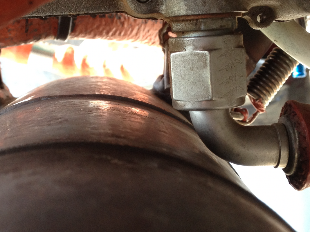

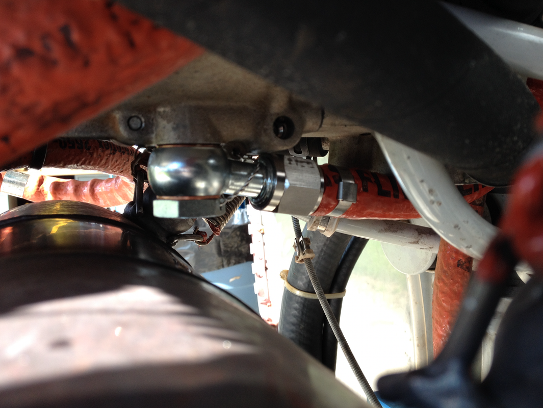

Just a quick word of caution? be careful if you decide to move muffler aft. Check for muffler / oil drain line clearance. Muffler, in some installations, is very close to oil drain line elbow on bottom of crankcase. I replaced with Aircraft Specialties Conductive Teflon hose with Banjo fitting for extra clearance.
