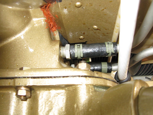

Seems a common source of small oil drips are the little rubber hoses joining the hard lines from the cylinders to the oil sump...the oil "scavenge" or return lines. Hard line from the cylinders to rubber hose to the engine.
Why don't they use flexible hoses all the way? IIRC, the engine connection is an NPT fitting with a nipple or barb...couldn't one put an AN fitting with flared tube on that end, and then run a flex line with flared ends at both ends between the cylinder and the engine?
I don't plan on doing this, of course, just wondering why it's such a jerry-rigged, cobbled-together-looking combination of fittings and aluminum tube and rubber hose and hose clamps, and not something more, well, elegant.
I'm guessing full length rubber lines may not tolerate the heat very well, or at least didn't in the old days. Baffle exit air temp is about 240F on my 390, plus there is radiant heating from the exhaust header pipes.

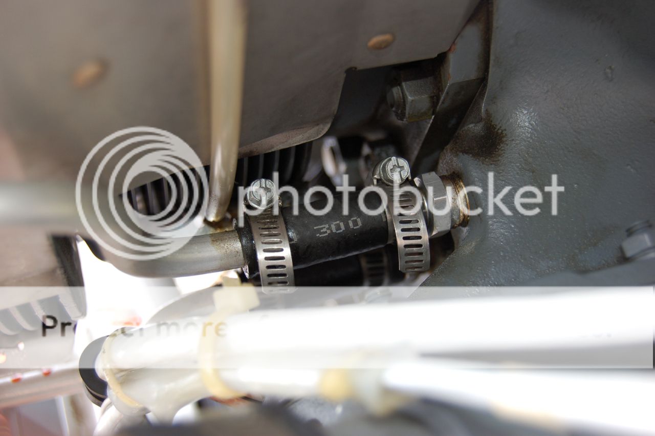

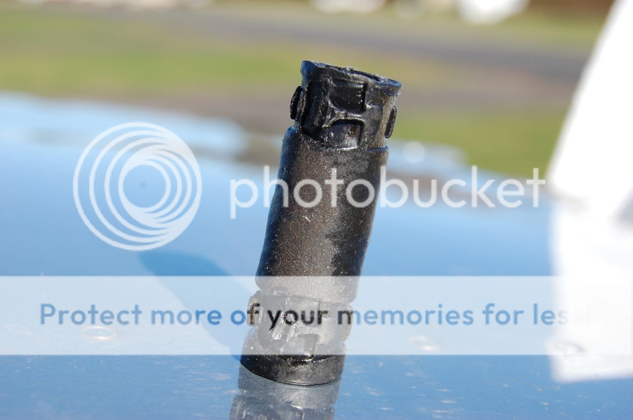

In any case, the only real problem is the cheap hose clamps. Over time ordinary hose clamps extrude the rubber hose sheath out through the slots and lose clamp force. In addition, often they are not very round when tight.
As soon as you get your brand new engine, replace all the clamps with the correct size ABA clamp:

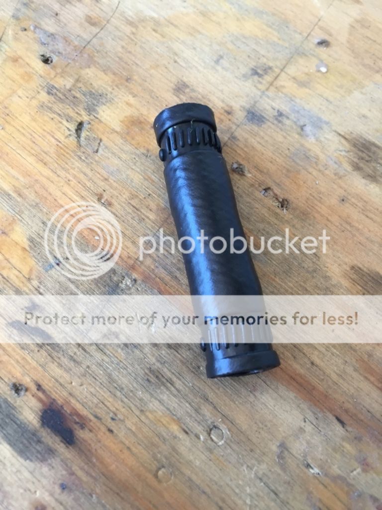

I replaced leaking oil return hoses a while ago. They were extremely hard, completely misfigured and soaked with oil. I wish I did it earlier I was just tightening and tightening those clamps. :eek:

An excellent example of why you should never use band clamps with slots. Much of the original clamp pressure bled away when the rubber extruded through the slots. Use solid band screw clamps or constant pressure spring clamps.

I'm in the middle of my condition inspection and decided to replace these hoses as well. I pulled them out and they look just like the one pictured above and are as hard as a rock. The spec on MIL-6000 hose shows 3/4 OD, my old ones measure closer to 11/16 so probably the smaller size would be best. Have you located a good source for these ABA clamps?

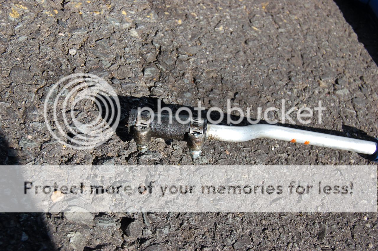

I marked this flag awhile ago so that at my next annual I would take a look. Sure enough, after only 120 hours almost all of my return lines have a good showing of oil drops and dripping that has made the firewall area messy. I removed one of the tubes and like Vlad, it is very scored by the default clamps. I have new MIL 6000 3/4" hose from ACS and just ordered some ABA04 worm clamps from Wicks as I can't find a source for spring clamps around me.
