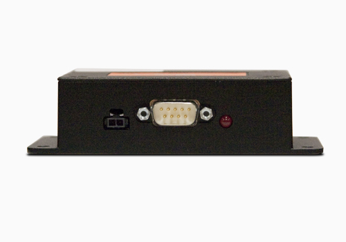

Unable to find a post regarding causes of DA/Temp fluctuating indications. Any suggestions?

Since DA calculations use temperature, look for a loose connection from the OAT probe to the SV.

I didn't build the bird, but looking at the KAI and the probe location I'm heading for the port wing root area and looking for a loose 22 gauge pin??? I should say, with the engine shut down it reads as it should, steady, its just with engine turning that both flicker and reading appear to vacillate...

Doug,
I'm at home and all my documentation is at the hangar. I wont be there until tomorrow afternoon. From my recollection, the OAT wiring harness goes back to the ADAHRS-200 (in the fuselage) and terminates on a nine pin connector. There might be an intermediate connection in between, but I'm not sure at this point.

No intermediate connection. It goes all the way back to the ADAHRS. The OAT connector is the small one to the left of the d-sub 9 (see picture below).
OAT wiring see page 14
