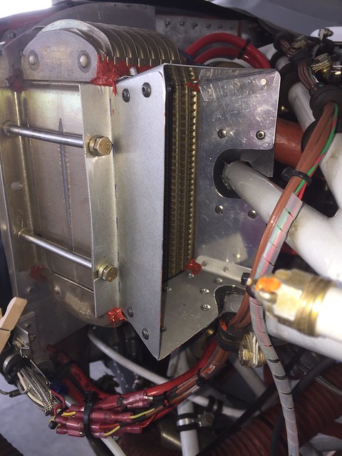

I'm looking to further optimize my oil cooler setup, in a ROP cruise I'm seeing temperatures between 210-220 *F at OATs of around 40*; CHTs in this cruise regime are 380-390*; my engine is a parallel valve 320 with piston squirters. My cooler is a 7 row Aero Classic (PN 8000075) supplied by -8 hoses, mounted on the firewall and fed by a 3" SCAT run from the rear baffle above the left side of the case. The cable actuated door under the cooler exhaust vents to the cabin for a form of marginal cabin heat. As the attached photos show, this is a decidedly non-standard mounting solution. The cooler is getting oil and air, easily proven by moving the door to vent the cooler to the cabin rather than the lower plenum, and seeing the oil temperature increase rapidly. Placing my hand by the vent tells me the cooler is warm, although there isn't much air going through it. Of note, cylinder #4 is typically my coldest cylinder.
Any input as to potential solutions here that could make this setup workable are welcome. I'm so far leaning towards 3D printing a bell mouth for the inlet and maybe a better transition piece for the cooler face. Moving to a 4" SCAT would be tricky with how the baffling is trimmed, and would need to be off #4 most likely, as there isn't sufficient room where the existing 3" duct flange is.
Picture #4 shows some of the baffle seal material and that indicates another item to consider as part of the optimization. I'd be surprised if there aren't leaks that are stealing cooling air from the oil cooler and the cylinder fins e.g. the back corner may not be sealing properly against the cowl and it looks like there are gaps where the rubber sheet has puckered up between the fasteners. How does the rest of the cowl baffling look?
With the limited info available, I agree with Mr. Rich. Chances are your setup provides plenty of mass flow; I would guess that it's not letting the air our (creating enough delta P). I'd try a temporary on the cooler outlet side down to cowl exit before I tried anything else. Keep us informed.

I see a few red flags - all of which are likely partial contributors.
- no bellmouth on the inlet to SCAT
- SCAT instead of SCEET
- SCAT too long
- Sharp, airflow unfriendly 90 degree entrance and exit from cooler
- Overall baffle leaks
If you are dead set on keeping that horrible remote mount, easiest solutions is to add a bellmouth, change to SKEET, and shorten the hose as much as possible. See if that helps and gets you into range. If not, I think it’s time for a new plenum top with a divergent design, with the inlet tube pointed at the baffle inlet (to shorten the hose even more), work on smoothing the exit flow out of the cooler somehow, and of course work on the overall baffle sealing.

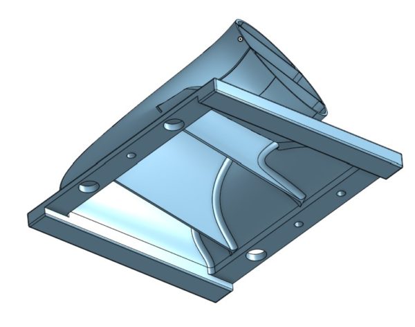

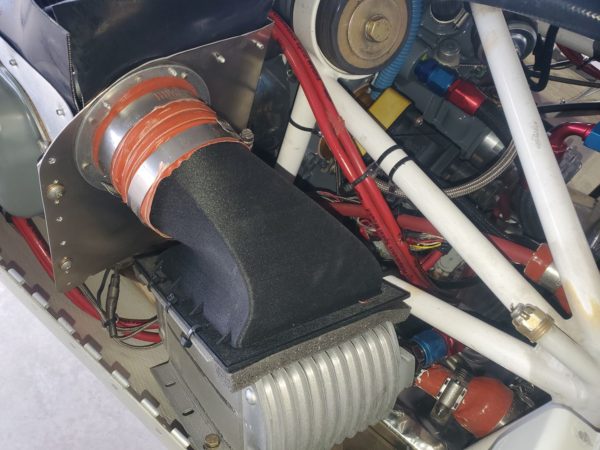

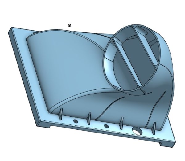

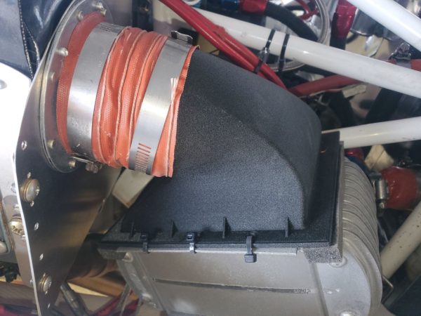

Finally got around to printing a plenum and turning elbow. The PETG bell mouth has held up surprisingly well, with no signs of heat distortion despite having a Tg of only ~176*F. Granted, it’s not really under any loads beyond its own weight. I had in my mind the general shape I wanted everything to take so I took some rough dimensions and got to work on the computer. Turning vanes are integrated into the elbow, and the plenum internal vanes borrows from hgerhardt’s design. On its face it looks nicer, trading that tight radius SCAT run for a much shorter straight section. The elbow will be reprinted to line up with the baffling a bit better before I actually test it.
The parts pictured were FDM printed out of ASA, which has a Tg of 208*F; I believe this is good enough to go fly and see how it holds up, and definitely good enough for testing the design. Fastener preload at the oil cooler face will hopefully let me know if the material is holding up or if I need to make a final production run with nylon.
That's pretty impressive. It'll be interesting to see what the actual improvement is when you go flying--especially now that it's summertime. Thanks for posting pics and following up. BTW, it looks like that may be SCAT hose; you'll get slightly less pressure drop with SCEET due to the smoother ID. Not a huge deal, but if you're looking for every bit of improvement, then...
