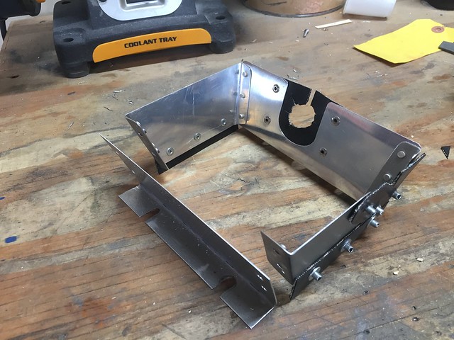

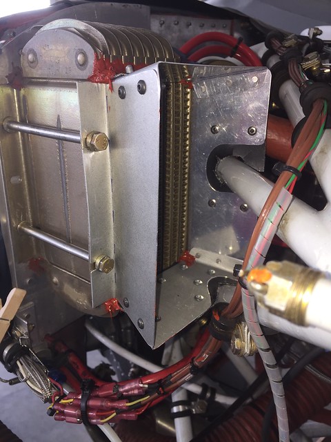

A while back, scsmith shared the concept of a diffuser on the oil cooler to smooth the airflow and thus make the cooler more efficient (thread here). I liked the idea, and decided to give it a go except with aluminum. I sized it such that the outlet is approximately 1.5x the inlet, and this is the result :
I'd never really had issue with warm oil temps, except when doing sustained climbs at Vy to > 10,000' or when doing extended ...umm... formation maneuvering with another aircraft at high power settings and relatively low airspeeds. Both of those arenas are no longer an issue.
Objectively, flight testing comparing under conditions as close as possible, a full power Vy climb hit 230º oil temps well before hitting 10,000' while the same test got to 10,000' with temps at only 204º. There's more flight test info, but that was enough to convince me this was a good idea. Thanks Steve!
Great. I'm glad it works, and thanks for the useful data.
What this really does is increase the area at the exit of the flow path of the cooler, so that the exit pressure is set at a larger area. This means that at the smaller area where the cooler itself is, the pressure is lower and the velocity is higher i.e. more flow through the cooler. It is equivalent to putting the heat exchanger at the throat of a venturi.

Nope, did not do additional testing beyond what I did initially as that testing confirmed that the diffuser objectively improved the situation. Tests included the climb as mentioned above, time to cool after reaching 235º, and a couple of others. All of them showed an obvious and statistically significant improvement vs. no diffuser.
Anecdotally, I used to have to call a knock-it-off during mock dogfights due to high oil temps but haven't done that since installing the diffuser. That's difficult to quantify since it's a dynamic environment with lots of high alpha/low speed/high power settings for varied amounts of time. But it definitely eliminates the oil temp issues during those kind of flights, so it's not coming off any time soon :)
