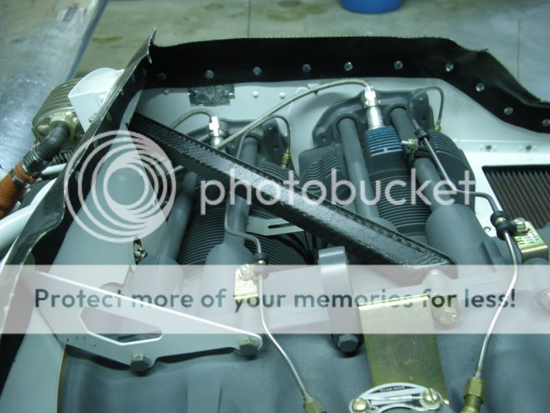

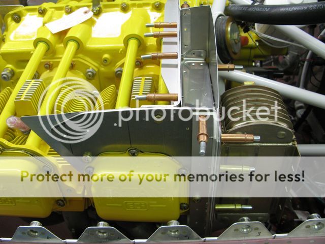

What would be the best way to repair this. The bracket that attaches the oil cooler has separated. Actually the baffles on both sides were cracked in a couple of places because they were joined together at both cylinder heads, and there was no expansion joint. Any ideas on a sturdier way to attach the oil cooler.

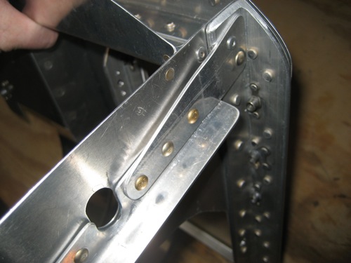

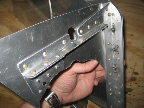

Heres a picture of how I did mine...
I think if I were you I would just remove the complete damaged section and build a new reinforced one.

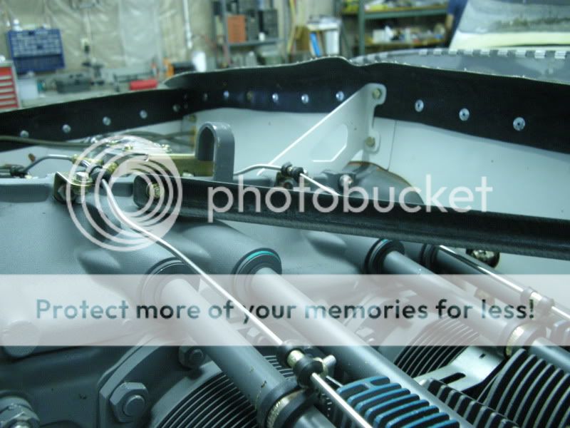

Added the above image to show the brace on the inboard side of the cooler.
Me too.
Agreed with Walt's suggestion. I had a similar crack though not nearly as bad, and I suspect mine was due to the oil fitting/hose hitting the engine mount during start/stop when the engine moves the most.
I replaced and reinforced it, but also turn the 90 degree fitting to allow more clearance to the engine mount and have not had any issues since.

Incidentally....no use trying to repair your baffle. Replace the whole left rear baffle at the oil cooler and modify it to add stiffness.

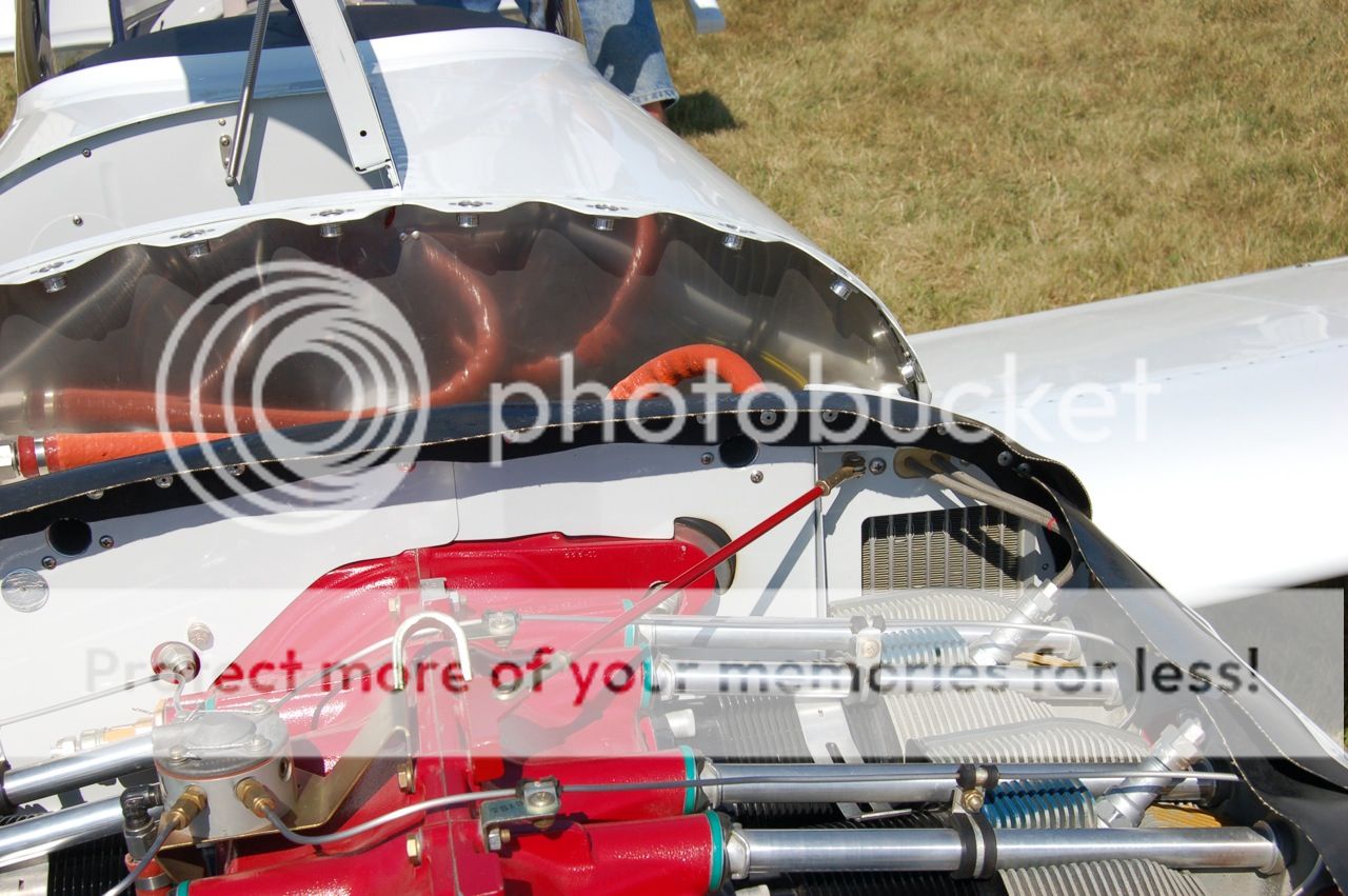

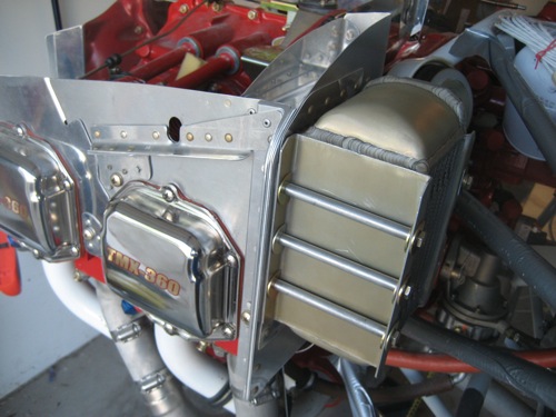

Reading how many folks with the standard setup experience this failure I have probably gone overboard, but hey.
I have sandwiched the corner of the no. 4 side baffle between two bent angles. The one with the notch goes on the inside. I've also extended this down a bit to hold the alternate air control cable (credit to Rick Galati for this idea). Although not visible in these photos, like others have posted, I've riveted an 1/8th angle to the aft baffle to accept a brace from the engine case.

I installed this support-rod last summer and no cracks anywhere so far.

Fixed it with new parts and a big 1/8" angle riveted in that corner like Matt and a brace similar to the post #8.
I would say it is more common than not that this corner cracks if you follow Van's plan...

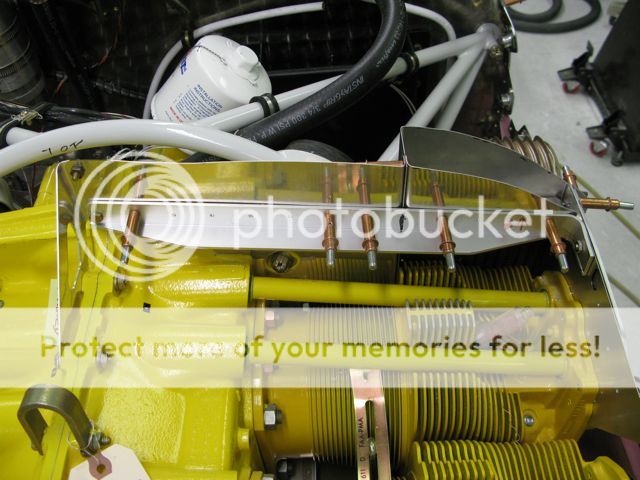

Here's what I did: Fixing the baffle cracks. One of the things I discovered as I reworked the baffle is that putting a cross brace and a piece of angle on the baffle inboard of the cooler both help stop the flexing in that area. Not enough hours since the repair to tell if my design will stop the cracking but I have hopes.

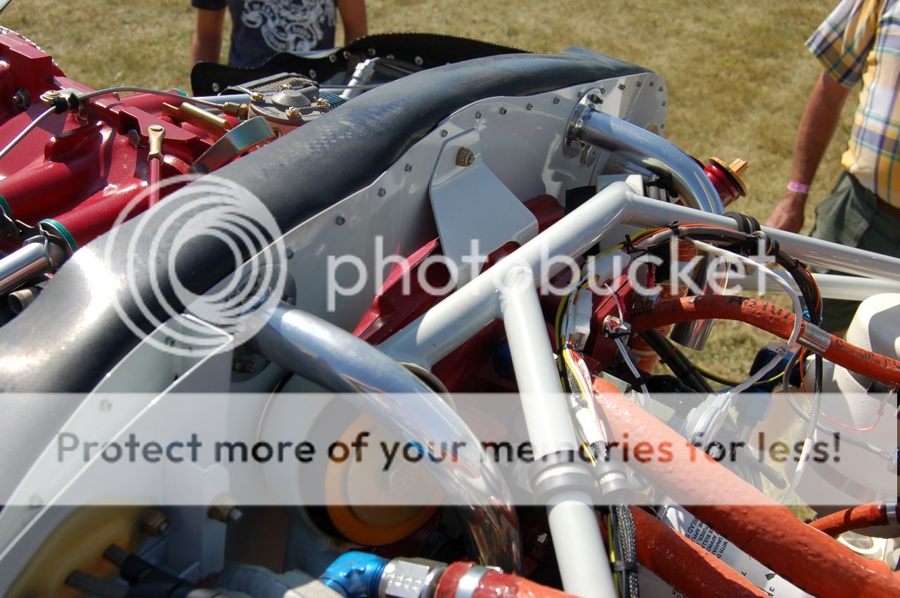

I'd be a bit concerned about the eccentric loading on the right-angled bracket attached to the crankcase. It seems to me that axial loads through the stiffening angle attached to that right-angle bracket might tend to loosen the crankcase bolt. If the bolt backs off then the crankcase seal could be compromised. Additionally, if the bolt backs off then the bracket can rotate and the fuel injector line (attached to the bracket) might fatigue and crack under the oscillating movement.
I just finished building this part of the baffles last week... based on others' advice I reinforced this area considerably. Some pictures that may help:

I noticed your brace to the cylinder. There was a lot of discussion about this location vs tying to the crankcase. I am not sure there was any definitive yes or no, but Captain Avgas provided a couple links. The first link has a lot of discussions about the topic. Just something to consider reading.
Oh believe me, I read every VAF thread about oil coolers I could find. :) My reasoning is that since the rest of the oil cooler is supported by the very same cylinder head, attaching the extra brace there ought to be okay. We'll see how it works.

Matt, I agree with you entirely. The original Van's design for the mounting of the oil cooler is predicated on virtually all loads being transmitted directly to the cylinder head.
I'd have more reservation about bracing the oil cooler to the crankcase. I like the idea of the oil cooler/cylinder head assembly being able to move independently of the crankcase to accomodate differential thermal expansion.

Matt - I have bracing very similar to yours and its worked great for 500 hours or so. I think your reasoning is sound. The original setup per Van's cracked after about 200 hours.

Thanks Alan, that's a great data point! Since we're all left to our own devices here, it's good to hear from someone who's already paved the way.

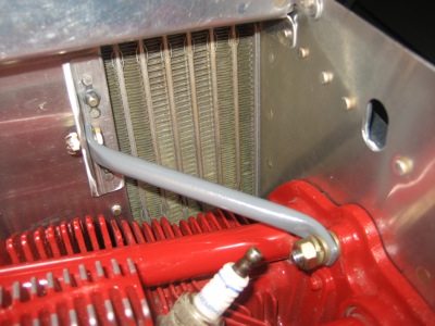

Mag cooling tubes, looks like to me.
BTW, mine cracked as well within 25 hours, and I used the 1/8" angle to support it. Plenum seems to support the other side very well...

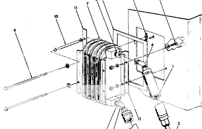

Chad, you might like to consider shaving a bit off the length of your cooler bolt spacers and inserting a large washer at either end to distribute the loads from the spacer to the oil cooler flanges. The spacer tube has a tendency to crack the oil cooler flanges if the load is not distributed over a larger area.
Or just use a spacer/clamp strip about 1/8 inch thick on the inner (nearest the cylinders) flange to spread the load. The outer flanges are less critical.
This is one certified O-360 installation and you can see these strips (#11 - note that the bottom arrow is slightly off...:)..)

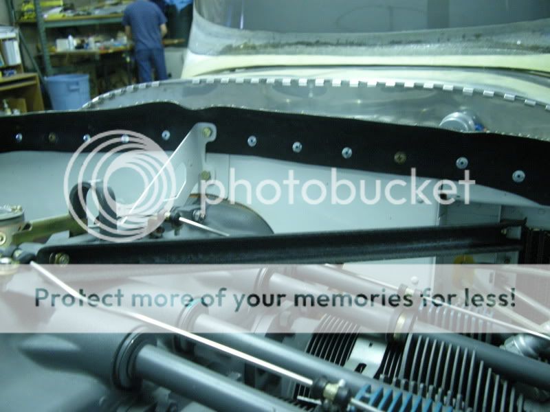

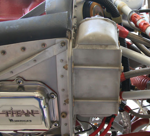

About 5 years ago when my baffle cracked in much the same way as others, we repaired the baffle and added a brace to the cylinder head similar to what Matt's photos show. In 5 years I have had no problem with baffle cracking... It would appear that this strategy works very well.
If anyone needs additional info, please let me know.

Here is how I fabricated my oil cooler corner.
I will report on the performance in 2012. **EDIT** 2019, 800 hrs, still good. The J channel worked great.
I did some metal bashing to form stiffening flanges that were not in the plans and also added a J channel to stiffen the rear baffle. It is quite stiff.
Operation will prove whether it is enough or not.
