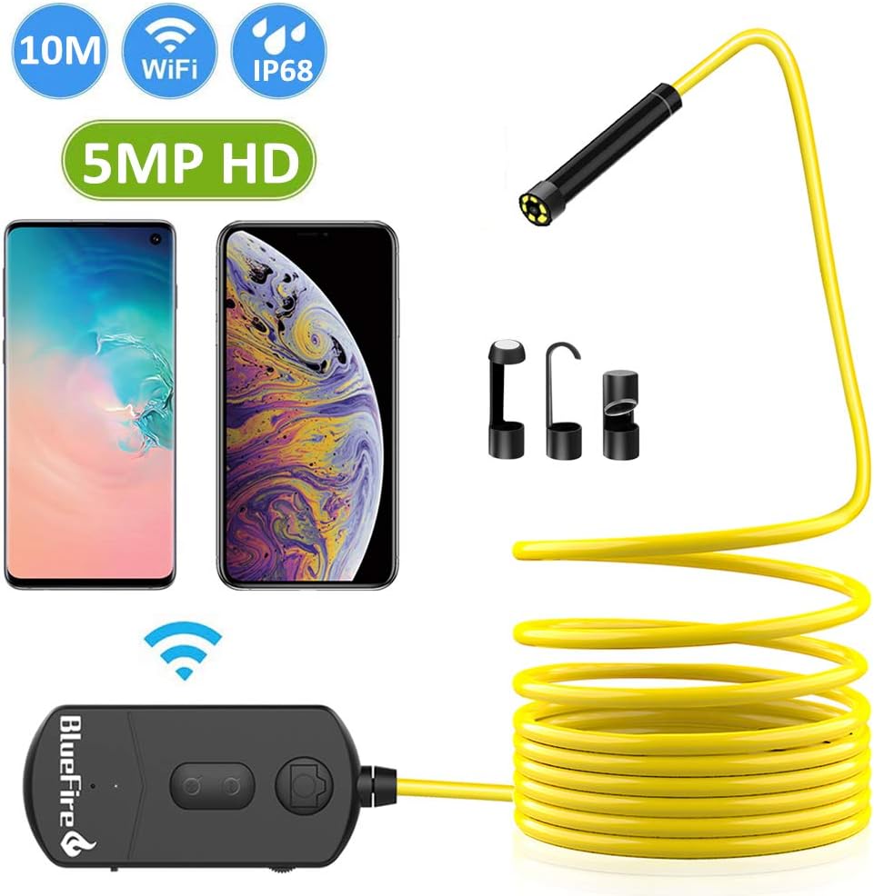

borescope
Borescopes are cheap - just buy one and have a look.
https://www.amazon.com/s?k=borescope+wifi

PPS. That Depstech borescope that rv8ch posted doesn't look ideal for cylinder work unless the head itself articulates? Need to be able to turn back 180 degrees right at the head to see everything. The Vividia ones for $199 or $399 do have that capability.

I too bought a borescope and hope to get my plane back tomorrow. Going to take my time with this. My biggest concern now is even if I bite the bullet and pay for a rehab of my top-end, I afraid to try to break the cylinders in. I read some horror stories about others who have done this and couldn't get the cermanil cylinders broken in properly, even the second time!
I think you'll make out well with yours. If I remember correctly, nitride coatings are to harden the steel cylinder. So you should have a pretty normal cylinder to break-in. Good luck with it. I don't have a mechanic on the field so I am going to proceed cautiously. If I take off a cylinder, I have to be able to put it back on.:(
