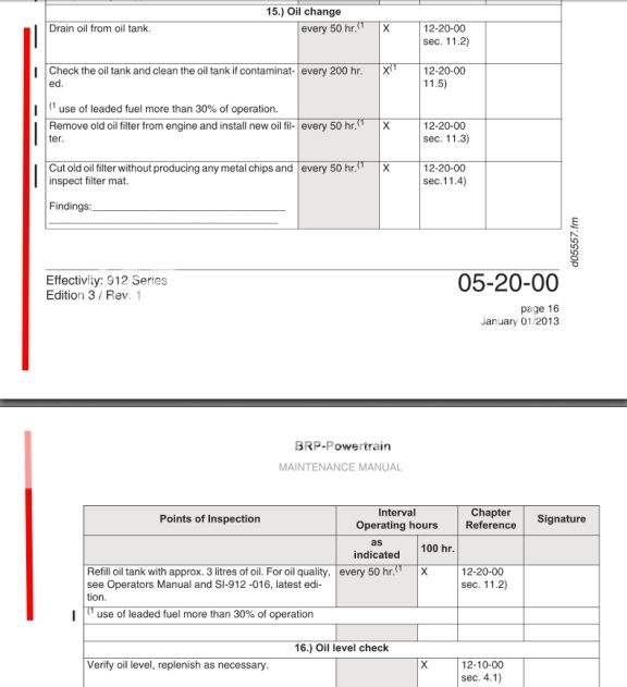

Right From the Rotax Maint Manual - Edition 2 - Revision 0
Section 05-20-00
Page 16, Paragraph 14 Oil Change
Oil and filter change at 50 hours unless 100LL is used more that 30% of the time. Then it is 25 hours.
edition 3, rev 2, feb 01, 2015
every 50 hrs if you use avgas, 100hrs if you use unleaded fuel.
maybe it was different in the older manual, but this is from the most current manual.
Section 05-20-00
Ahhh, OK, I see where at least some of the confusion lies: Edition 3, Rev 1 of the Maintenance Manual, which I think is the latest except for some change pages unrelated to this, gives 100 & 50 hrs respectively, if I'm understanding it correctly, rather than 50/25 (http://www.vansairforce.com/community/showpost.php?p=1073892&postcount=10). Looks like they've changed their recommendation.

What actually causes the confusion is that the 100 hr / 50 hr in the Line Maint. Man. are the required intervals.
In the recommended fluids Service Instruction ( don't remember the # right now) the recommended intervals are 50 hr and 25 hr.

Oh, interesting, thanks, I missed that. Have to chase that one down.
rvbuilder2002 and tom,
SI-912-016R8 paragraph 3.3 (link below) does suggest 25 hour intervals with the use of leaded fuel. I don't remember ever seeing it written that 50 hour intervals should be followed with mogas. Even so, It's a good idea to follow a 25 or 50 hour interval, depending on fuel of course.
