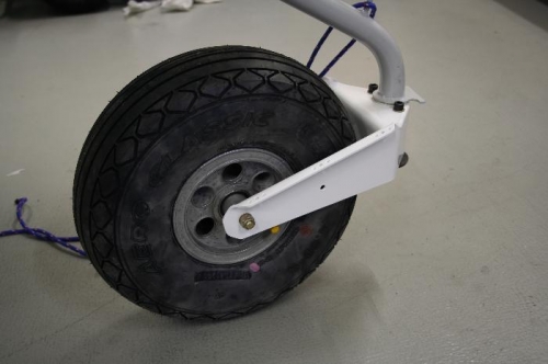

Here are the two upgrade kits. The blue bracket parts on the right are the wheel fairing kit needed to adapt the nose wheel fairing to the new fork.
This fork is one beefy hunk of metal alright. Some have said it is ugly, but it looks good to me; I like it. It will be inside the fairing anyway most of the time.
I notice that the design of the axle has been changed so the axle bolt can now be torque tightened without danger of over-tightening the pressure on the wheel bearings. The wheel is kept centered in the fork by 2 wavy washers on each side. Nice change.
