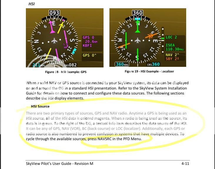

Tried the autopilot for the first time today. Everything seemed to work okay, except that the roll-axis mode options only included HDG and TRK. No NAV mode option, so I couldn't get the AP to follow the GPS.
Is there a configuration setting that I need to set up to get the NAV mode to show up? Couldn't find any info in the Dynon manuals or this forum.
Any advice much appreciated.

Hesitate to mention this - it is so simple, but remember having the same question when I first tried version 6.
The answer for me was that Nav mode needs a flight plan to follow. Nav mode appeared when I put a flight plan into the map. As simple as "direct to" and anything else worked.

Try this!
You should have a picture similar to the left one.;)
Must have GPS 0 source selected
Jetguy has it, must have the GPS 0 source selected.
I had the same problem when I first started using my Skyview.
Jetguy and Skunkworks have it - when you select GPS 0, you will get the NAV button and you can hit it and the A/P will then navigate the Direct-To Course Line.

Or GPS 0^ - now it says Skyview - that should clear up a lot of this kind of confusion.
