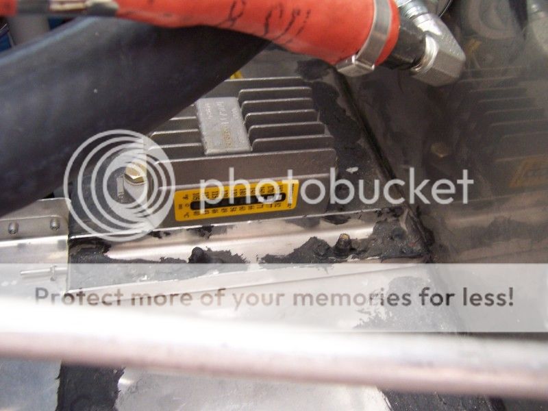

F Y I - - - -
I put some of these on recently because we have had unusually hot weather recently. The 150 F block is blackened, so that is as warm as it has gotten. Nothing extra like lights etc., and no cooling hose. Maybe this will help.
John Bender
419.4 hours
Temp labels...
I use them in several places too. The only problem is that they are exposed to radiant heat and heat after shutdown which can be higher than internal temps. My pp 60a alt indicates 300F on the side closest to my #1 exhaust pipe. My fuel pump and mags indicate 225F. No cooling blast tubes installed.
