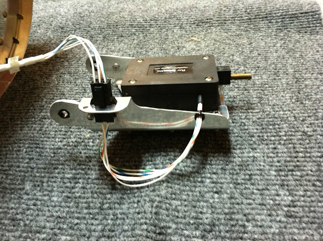

Thought you guys might want a look at the new trim connector. Enjoy.
Pins and connector
Pins inserted
Connector attached to servo tray
Trim Wire Connector
Trim Wire plugged into tray.

I have the old tray but haven't installed the servo and wiring yet. Would you see any problems in making a small angle bracket for the new connector and riveting it to the tray? That way I wouldn't have to throw the lot away and start again.

Nice pics Bruce. Unfortunately the new trim wire does not have any extra protection as it bends around the aft j stiffener.

Sure beats the conglomeration of spade terminals and receptacles that were there before. After inspection I removed the terminals and just soldered the ends together. Took all of 10 mins to do.

I believe this is an update to the kit. All new kits will have it and older kits have the option of updating it with a call to Vans. As I understand it the original way is fine. Builders choice if you have the older kits.
You can upgrade the trim motor connectors by ordering the "12 Trim Wire Upgrade Kit". If you want a factory connected wire you can also order the WH-P30 late version (out about one week).
