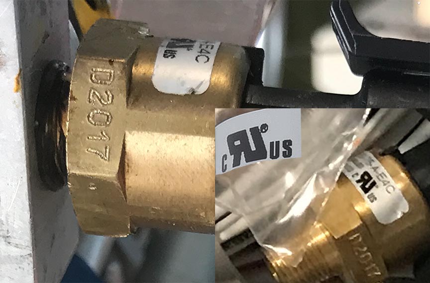

Van's service bulletin 00006 reference potential leaking of KAVLICO pressure sensors. We're fortunate that Van's is forwarding this info to us. Check it out.
Not a Kavlico Pressure Sensor?
Looks like mine is not a Kavlico Pressure Sensor. I'm not clear what brand it is I have tried to do some research and can't seam to find any manufacture info. Anyone recognize this brand. The last three of the part # are E4C. I don't have a photo of the entire P/N in my photo archives. Maybe someone else has one too?
I hate taking the cowling off my factory built RV-12 to check because it is not uncommon to chip a little paint. Does anyone here know if a 2015 RV-12 SLSA uses Kavlico pressure sensors?
