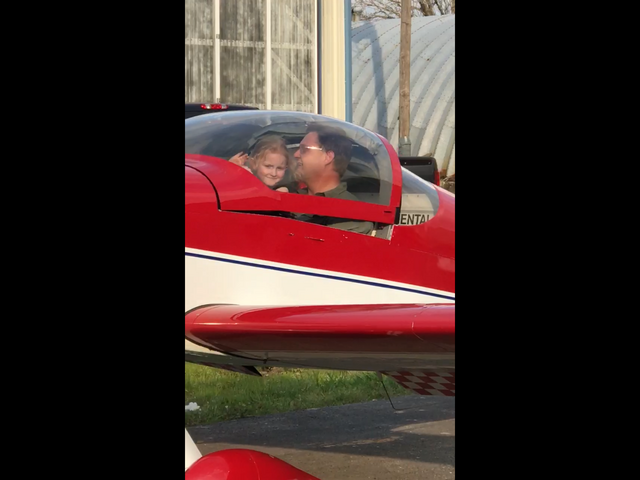

+1
Never had an issue getting good airflow in my tipper if you prop it open like this.
