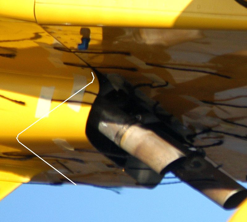

How to open outlet
Does anyone have pictures, or drawing of the ?45 degree? cut that is mentioned? Unclear on how this is implemented.
Wayne
N1179J. Purchased flying.
2019 donation.
Wayne
2019 donation.
I would also like to see some pictures to better understand how the cut would impact the interface with the center bottom support on the A models. Would a half-round cut on the sides of the exit be effective? That would prevent changing the center support. Maybe some kind of scalloped edge?
I will look on this sight. There are pics somewhere.
I cut mine about 1 inch down and then toward the front of the exit.
Both sides, then open up about 2 inches and then reglass.
With the A model it opens it up as Dan said ~41%.
Boomer
Yes, you would need to modify and/or eliminate the A-model brackets. What do they support?
Thanks for pic Dan.
Found the old thread but no pics.
Dans way is great if you don?t want to extend bracket.
On mine I made the cut at second piece of yarn, forward ~12 inches
Pulled it down 2.5 inches and reglasses.
Extended the brace.
If you take off the gear leg fairing it will slide down and rebuild brace.
I did have a Vettermans 4 pipe and it was real tight.
Look at RV-8 OR TD and you will see the exit difference.
Boomer

(2) Or, why not enlarge the standard exit? A simple 45 degree cut increases exit area by 41%. Costs nothing and can be done in 15 minutes.
Ease of installation and low impact on already painted cowls was a consideration. Along with other details and changes that could be involved with supporting the bottom of the cowl on "A" model installations ;)
This is what I did - but I only ended up taking 1.5" off rather than the nearly 12" shown. I trimmed .5" at a time up to the 1.5" where the CHT's came under control for cruise, and then added the servo-louvers from Anti-Splat for hard climb scenarios to keep the oil temp happy.

I have completed my install up to bending lovers from flat to 45 degrees and riveting down. Not a builder , so question is how to properly bend the tabs/louver. I cleco?d down and am hesitant to try to bend as the material between each opening is not all that stout and afraid it may flex and break. No reason they cannot be pre bent to 45 before riveting in place, just unsure of best way to do. I have access to straight blade seaming plyers......should I lightly score a line to help with bend or should I use some other better method. Have bench vise too. Thanks
I used my thumbs, then seaming pliers on mine. I did them off the airplane.
Thanks Kyle. I took a scrap piece of 2x6 and some drywall screws and mounted it, got fingers under edge enough to come back with borrowed seamer plyers. All finished about remount cowl.
Sounds like you got it sorted but for future reference, never score aluminum for bending (or for any other reason except maybe to mark for a cut) -- that'll just set it up for a crack there in the future.
Thanks Randell , a good friend and 7A builder texted me the same. I appreciate builders looking out for us buyers :)
