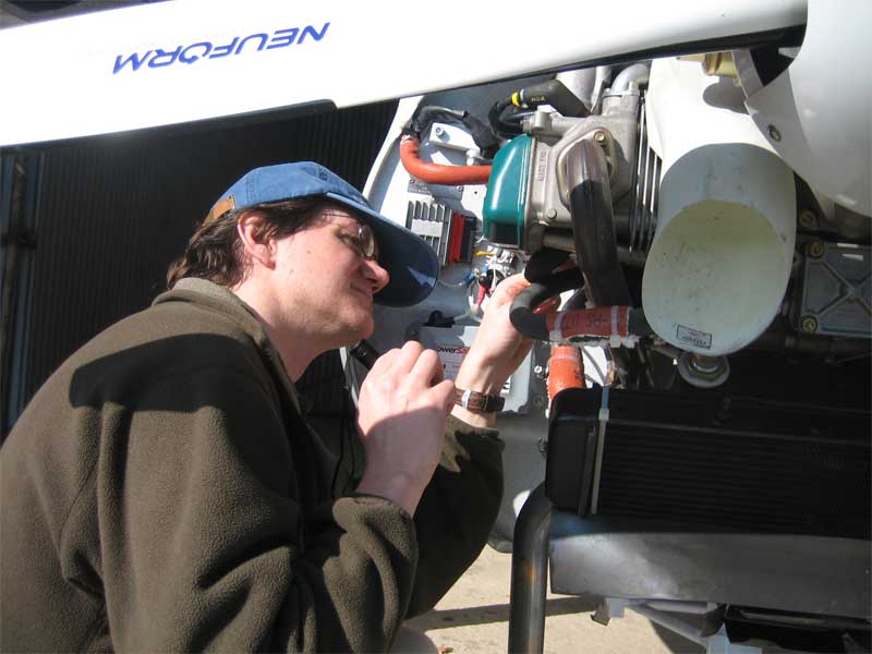

The two radiators for the Rotax are not very large. The oil radiator is about 9inches across, 2 inches thick and about 5 inches in height. It weighs 2 pounds. The coolantant radiator is about 15 inches wide, 1.5 inches thick, and about 6 inches front to back. It also weighs 2 pounds. The oil tank, sans oil weighs 3.5 pounds. One thing folks seem to forget about the Rotax is its small physical dimentions; in particular,the narrow width across the cylinders. This allows for a nice slim cowl front, which translates to good fuselage aerodynamics. All you have to do, to see what putting an O-200 engine in an A/C in place of the Rotax , is to look at what happened to Cessna's C-162 Skycatcher, when they switched from the Rotax. The nose cowl went from slick to butt ugly! Steve
Some images of a Rotax install. Note the stubby nose cowling. My head is (perhaps) useful for scale. It is very compact.

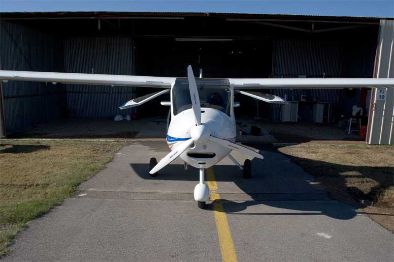

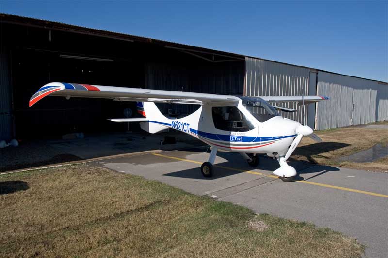

I flew a Sportcruiser a few weeks ago. The Rotax is a great little engine. Smooth and quiet. After I get over my disappointment about the cruise speed, I'll probably talk myself into a 12. There are a lot of other advantages to the design. :)
The implication was that it would add about 4-5 mph to the cruise. Anything helps, but it still comes up short, depending on how you interpret LSA rules (sea level speed Vs "at altitude").
