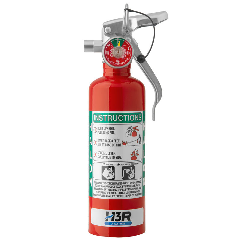

2. Fire extinguisher: suggestions on a good one to get, that won't eat too much into the useful load and/or baggage space?

More expensive but it's a proven model.
Yes, halon. If you have to use a dry chemical extinguisher on your aluminum airplane it's likely to suffer corrosion issues forever.
