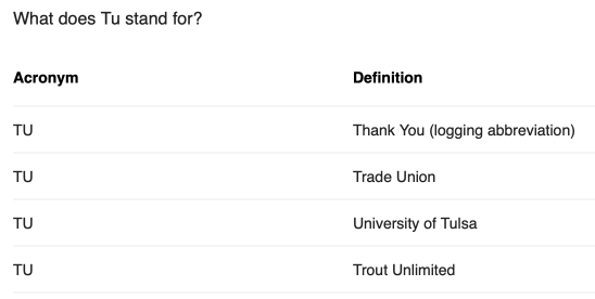

In this photo you can also see a dedicated ground wire back to the battery negative. And I used nut plates on the panel base so the regulator mounting screws could be removed without removing the top instrument cover and longer screws with standoffs. This makes the regulator relatively easy to change in the event (likely) that it goes TU some time in the future. Carry a spare.
