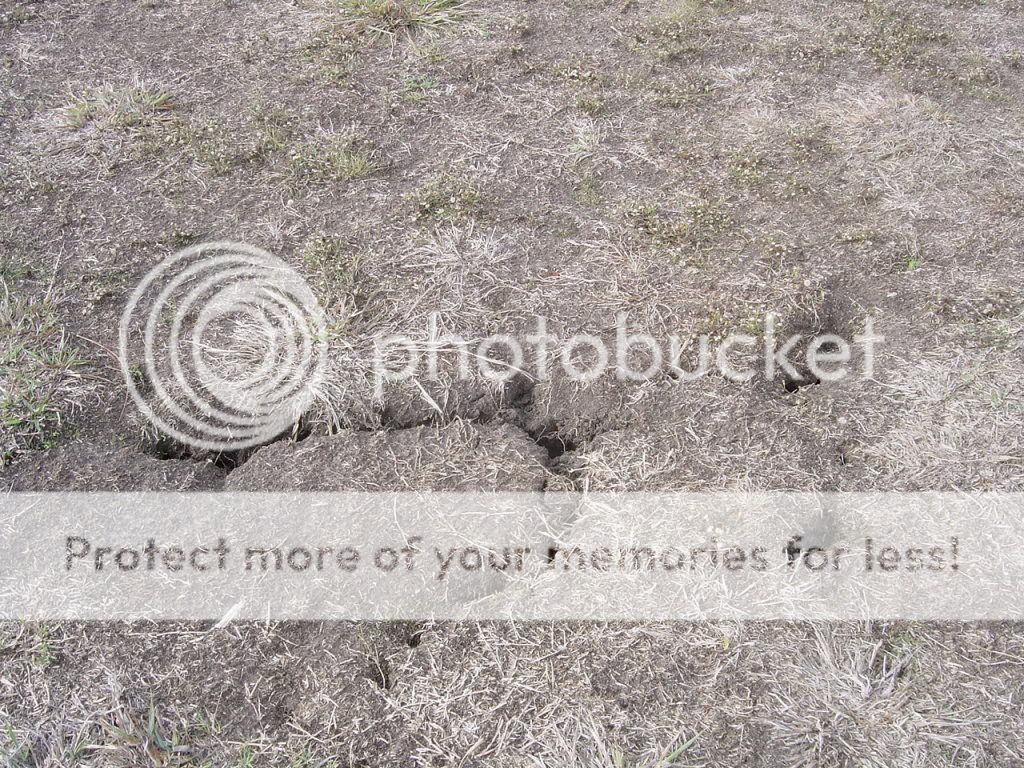

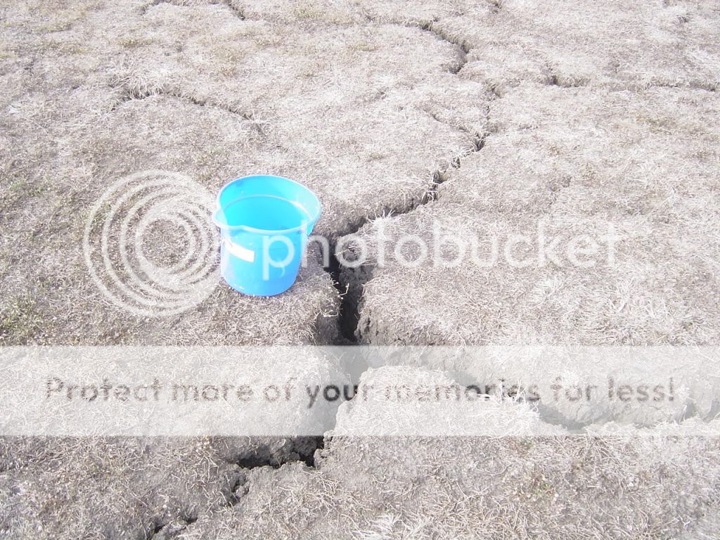

Black Dirt
I still believe that those of us who fly off of unimproved landing strips could benefit from this device. I've attached a couple of pictures of our runway and taxi surface to show the abuse the nose gear could easily go through if you're not looking where you are going. The bucket is only there for size reference.
[/IMG]
I thought someone left the bucket there after a vain attempt to get the soil to expand with water. :D
