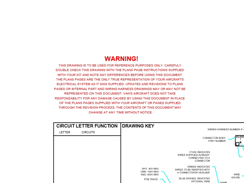

If your using the schematic downloaded from Van's...somethings not right.:confused:
See Van's RV-12 D-180 schematic download HERE.
And don't even think about following the VREG circuit...must have run out of orange ink...:rolleyes:
But I think Joe is correct in the diode wiring. To the battery terminal.
Good Reading...on this topic.
Regards,
So, I'm looking at the schematic you reference and it still shows the diode on the load side and not the battery side. The schematic included in Van's digital files also shows diode on load side. My diode is on the battery side. Now I'm confused.

Jim, you are correct about Van's schematic showing the diode on the load side. However, the schematic is WRONG. Take a look at plans page 45A-08. It shows the diode on the battery side. Arc suppression diodes are connected across coils. The coil inside of the contactor is connected to the battery side, NOT the load side.
I have faxed a Builder Feedback Form to Van's pointing out this error.

The ES Diode Master is shown on the battery side on the SkyView Schematic.
D-180 guys please ignore the ES-00165 starter relay diode shown in this picture as it exists in the control board on the D-180 panel.

I was not trying to create more confusion... Only pointing out that I thought the downloaded version of the wiring diagram was wrong and incomplete. And that Jim would be confused if using it as I was troubleshooting from it. Didn't know the flash version was inaccurate too. Thanks Joe for reporting it. If I run across errors again I know what route to take.
That said the schematics disclaimer instructs as to what information has precedence...
But it would be nice to be all on the same page.

Thank you for that excellent schematic!:D
I installed the new Master Relay with my new wire that controls it which I soldered to the back of the master switch.
It may be helpful if you where to draw on the schematic where the trace was burnt, and where you installed the repair wiring.
