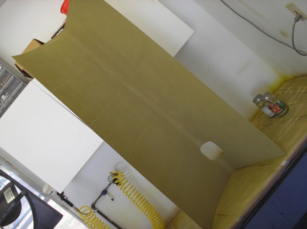

Steve,
I caught this too and planned on doing my own experiment to confirm the adhesion characteristics of the product.
I am using VariPrime and it is the tan color you describe. Here is a pic:
As far as sanding, I read that too. I ran it past the instructors at my school and we figure that the .5 mil coating would be comprimised as it it so thin if it were sanded. They say that when they have to coat the material after the curing process is complete, they lightly scuff with a scotchbrite pad to remove dust and provide a little profile. Then they vacuum and lightly wipe the surface with a tack cloth.
:) CJ
