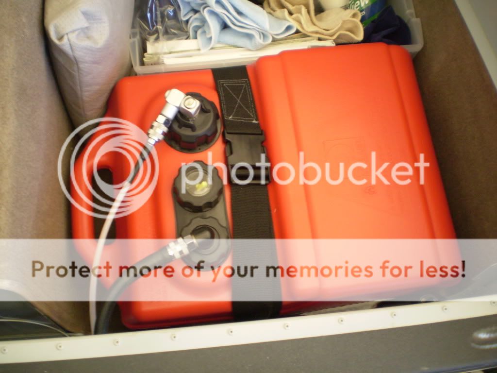

Why not just add one of these! Plus its removable!:D

Those marine tanks leak in negative gs, at least the two in my sailboat do. Since I remove them to take them to a gas station, and the gas sloshes around, it's a bit awkward. This happens even with the vents closed.
I see that yours are rigged to vent overboard, a very good thing.
Other than that, it's a neat solution. Removable, portable, inexpensive.

It's not all about range. It's about premium mogas. The tank allows us to fly out for two hours and back for two hours and not worry about fuel. Yes we can use 100ll but we want to keep the lead out of the engine and gearbox. $3.00 mogas is better than $4.50 100ll. I know it is not much but it adds up in the long run. We also save in that we can do 50 hour oil changes by running mogas whereas if we run 100ll a lot we must do 25 hr oil changes. I can't believe I am going to say this but, we are trying to operate this wonderful airplane green. How's that for ya. The RV12 is a green vehicle if you run mogas. Remember the tank comes out in about 30 seconds. If you don't need it don't take it. I do love having the option. Have some fun out there.

With the tank in the picture it is full until it is empty. The tank is pumped into the main tank when the main tank is at about 10 gallons. When we hit 10 gallons we switch on the transfer pump for about 10 min. all the fuel goes into the 20 gal tank and we confirm transfer by watching the float gage go to 16 gallons. Then add 6 gallons to the totalizer and press on with current info. The aux tank is empty so no sloshing. It works really well and remember this tank is removable so it can be used as a gas can at an out airport. Take it with you in the airport car get 6 gal at a local gas station an in about 2 min it can be reinstalled in the airplane or just transfer it into the main and do it again until the airplane is full. This system works quite well and we don't have to use 100LL.

The pump is mounted on the front left bolt for the main tank. A switched power port from Radio Shack powers the pump. The tank vent is just like the static port but is mounted in the inspection panel under the main spar. Yes they are quick connect fittings form Aero Cabelas. If fuel is in the line you get a drop or two but if you pump the tank dry we get no leakage when we disconnect. We are in the testing phase now and when we are pleased with all the parts we will put more out about the tank.
