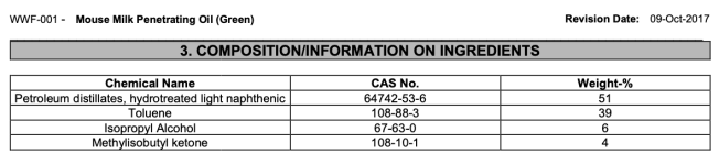

Seriously, I'm not seeing anything in there that would survive sitting on a hot exhaust.
https://www.mousemilk.com/Mousemilk_Penetrating_Oil_(USA)_EN_sds.pdf
Perhaps when you want to remove the exhaust and you need it to move a bit, putting some penetrating oil on there will help.
And there is this sales sheet:
https://www.mousemilk.com/MM_Tech_Spec_rev1.pdf
Ingredient list and sales literature says it's a penetrating liquid, like a great many other similar products, and possibly useful in loosening a stuck exhaust joint. Per the above sheet, it would work best if the joint was warm, but below the smoke temperature of the product. There's nothing to prevent seizure. The ingredients evaporate or turn to carbon at red hot temps.
