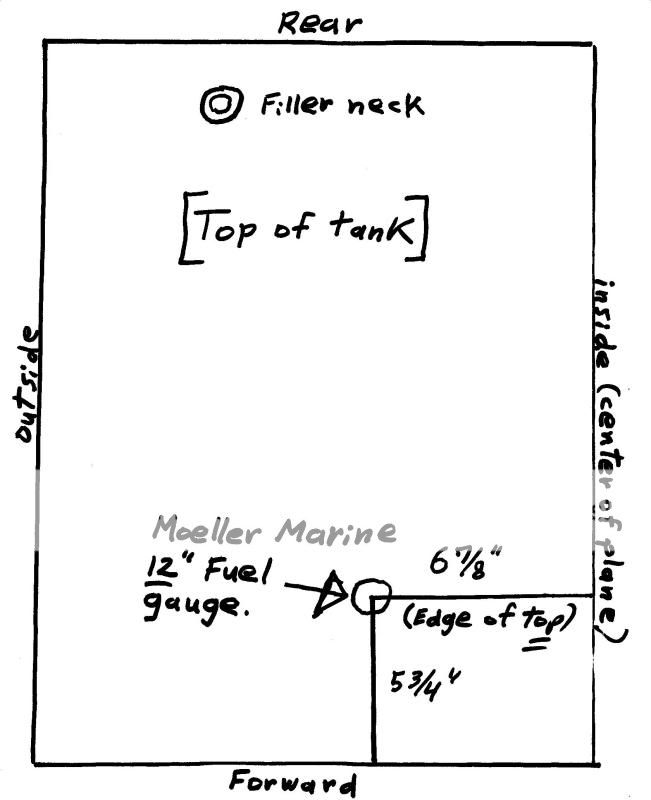

Ordered the gauge. Have to pull the fuel tank to repair a tiny fuel leak at one of the screws on the sight window.
Did not build the tank. My question is - what is the position to mount the Moeller gauge so it doesn't interfere with the inner workings of the tank.
Any help here appreciated!

I mounted mine a bit aft of the internal baffle that runs left to right on the bottom of the tank. Has to be near enough to the left/right centerline because the float arm will swing left/right as opposed to fore/aft. I have about 1/2" to 1" of clearance to the side of the tank when the float arm is horizontal.
With the float arm swinging left/right, the gauge face is positioned so it can be read from the pilots position. I can also see it during fueling. When it reads FULL, there is ~17 gallons in the tank.
Another fellow builder placed his just to the side of the filler neck on the flat. I don't know if you can see his as easily during fueling.
BTW, did your tank leak with the new sightglass material? Sightglass problem or screw problem?

Hey John! Time to rise & shine man!
John Bender has the measurements. I e-mailed him so when he wakes up he'll let you know.
YYYAAAAAWWWWWNNNNN
OK OK I'm awake !
